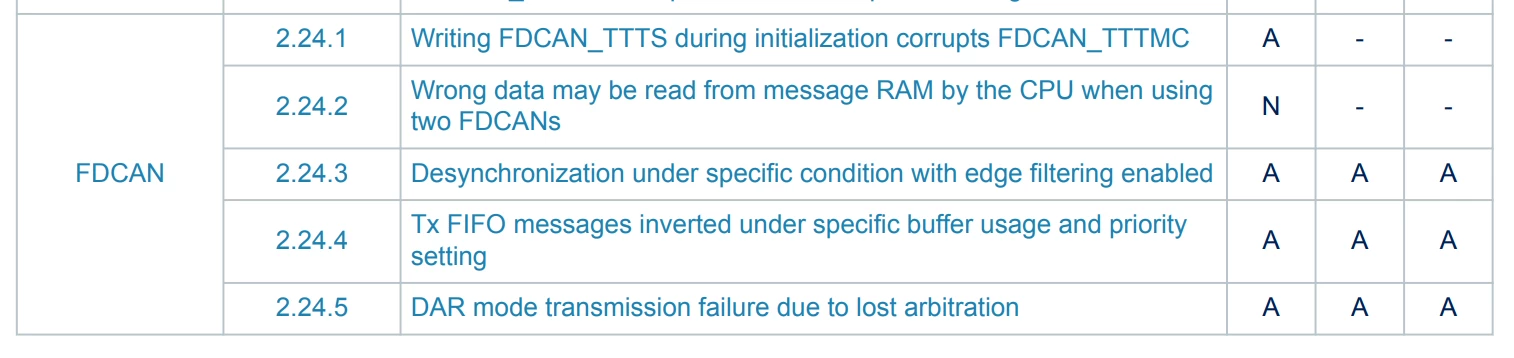

I have no CAN experience, but I have to decide soon if we can use the STM32 (prob. H7) with its CAN-FD interface.
To me with my limited CAN knowledge it looks like it supports all hardware necessities, like "old & slow" CAN and the newer, faster version with bitrate change.
But to make sure that I am not missing something important :
What are the limitations of the STM32 CAN-FD ?
What's your experience?
Thanks in advance!
Edit: I have checked / am reading AN5348 and the STM32 CAN-FD "presentation"

Hello ​@LCE
I know you are no more new to the subject and the thread is 3 years old but I’m trying to answer old CAN related questions as I can :).
Yes FDCAN supports both CANFD and Classic CAN fames 2.0A and 2.0B.
The FDCAN limitations are listed in the Errata sheet of the product. For example for STM32H743 (ES0392):
For CANFD mode, you can refer to this article:
For Classic mode, you can refer to this article:
Hope that helps you as well as others ..
