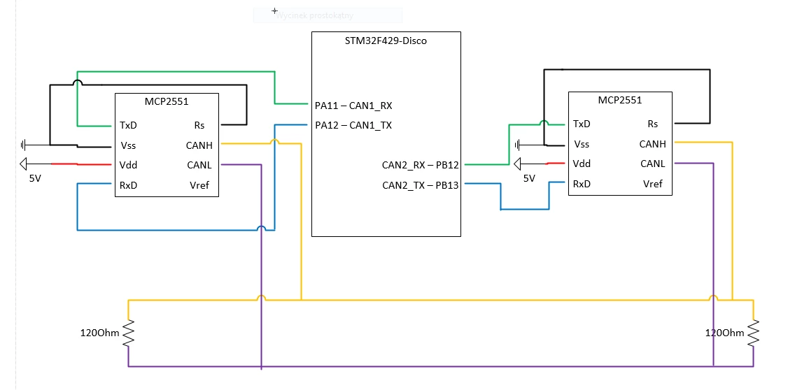

I'm connecting these two CAN interfaces through MCP2551 transceiver.
 If I change CAN mode to LOOPBACK and test, everything works ok, but when it is in NORMAL mode, it seems there's a problem. I cannot transmit anything through the bus.
Where am I wrong?

Is the CAN bus terminated?  Are you using twisted-pair wiring?  Are both nodes connected and enabled?  CAN won't run with only one node.
Look at the ESR error status register, especially what error codes youa re getting in the LEC.  If you see bit dominant or bit recessive errors check the cable and termination.  Are both nodes at the same speed, and is the bit timing set correctly for the data rate?
Make sure the filter banks are allocated properly.  You need to tell the CAN controller where to split banks between CAN1 and CAN2.

These is my scheme. I'll check with CAN split banks...
LEC gave me 0x03 error but now there's none.

Setting filters has to be through CAN1, not CAN2.  The two controllers are not fully independent.  CAN2 cannot access filter memory.
hcan1Filter.BankNumber = 0; // Select the start slave bank filter
HAL_CAN_ConfigFilter(&hcan1, &hcan1Filter);
Split your banks at 14 instead of 0 - filters 0-13 for CAN1, and filters 14-27 for CAN2.  You must set this using CAN1 since it's filtering.  Set this once for oth CAN1 and CAN2
HAL_CAN_ConfigFilter(&hcan2, &hcan2Filter);
You have to use hcan1 to configure a filter for CAN1 or CAN2.
  Jack Peacock

Your connection is wrong. You have to connect RX of CAN transciever to the RX pin of STM32, not TX pin. Same apply for TX pin.
MCP2551.RX ---> STM32.RX
MCP2551.TX----> STM32.TX
