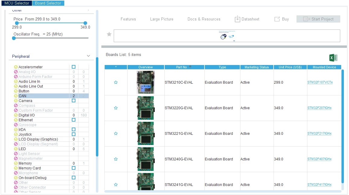

Amel NASRI
Feb 14, 2019 10:05 AM UTC
Hi @RColl.1​ ,
Using the selector of STM32CubeMX (or embedded in MCU-Finder) and filtering on boards having 2 CANs, I get this result:
Does it fit your requirement?
-Amel
PS: When asking a question in the Community, please put a title and describe what you need in the body. I edited your original post.
RColl.1
RColl.1AuthorBest answer
Feb 14, 2019 10:35 AM UTC
​Hi Amel,
Thanks for the response. I don't have STM32CubeMX software installed yet so I will get that done ASAP.
Of the five boards listed the STM3210C-EVAL is the only one with 2 physical CAN ports the others have 2 CAN channels but only 1 of them has been physically implemented on the eval boards.
I will therefore get the STM3210C-EVAL on order today!
Thanks again :)
Rich C.
