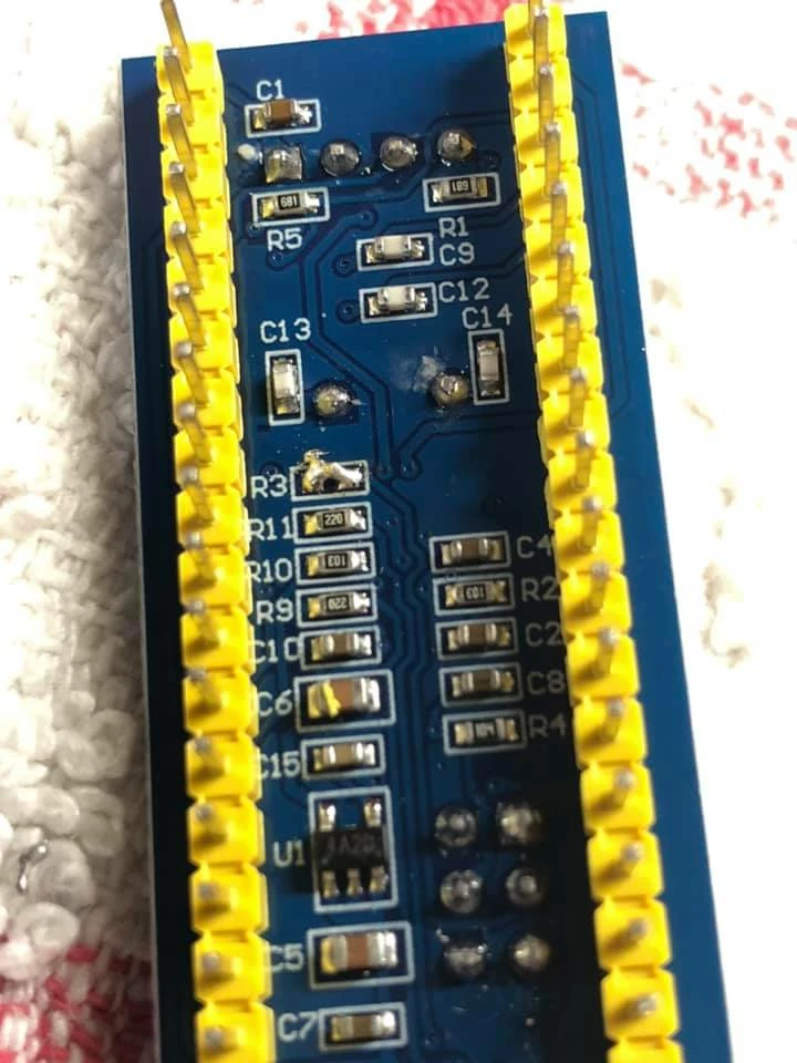

Hello everyone!
Problem 1:
I bought 8 STM32 Blue Pill cards.
I can't program these cards.
The problem occurs on all boards.
When I set the BOOT jumper 0 to 1 and press the reset button the LED connected to the PC13 pin always flashes.
I have already programmed these cards and I have always programmed using an FTDI using TX on the PIN PA10 and RX on the PIN PA9.
I have the ST LINK V2 module and I can program the card.
I added the RST wire because boot 0 does not work.
I usually use the Arduino IDE environment and programming with the ST LINK V2 module the USART PA9/PA10 serial are not activated.
I use the tab support for the Arduino environment:
https://github.com/rogerclarkmelbourne/Arduino_STM32
I tried to connect the FTDI module to the serial port of the card and it does not receive any data.
I programmed the card with ST LINK V2 and FTDI to read values from the serial port but it does not work.
Is there a way to set the BOOT 0 jumper to programming mode?
The Blink always works for me and there is no way to block the execution of the program with BOOT 0 to 1.

    Are you sure these things aren't counterfeit or defective? You should perhaps work with the vendor, get a schematic, and probe the circuit.
    Check the level on the BOOT0 pin, make sure BOOT1=LOW, BOOT0=HIGH to get into System ROM

    The System Boot Loader is in ROM/OTP so it can't be erased, replaced or reset. From the boot loader it should be able to erase the user application in Flash.
    I'm not sure why BOOT0 being HIGH wouldn't start the loader for you, so you will need to look for physical reasons, like the chip is damaged, or the connectivity is broken. Check voltage levels at pins.

    0690X00000BvsseQAB.jpgSolution: I had this problem. R3, listed as 100k. Has 104 printed on it. It was suggested to remove this resistor and replace it with a jumper/short. This worked on my boards. I have 6 boards with this issue. R3 is hooked in series between the MCU and the boot0 header pins. You can see the schematics half way down this page... freeelectron.ro/bare-metal-stm32-led-blink

    Same problem here. I weldered a short in R3 but problem persists. Only blinking led even changing the jumper.
    May be a problem in boot0 software?

    From the answers in https://community.st.com/s/question/0D50X0000AwWy5y/my-stm32f103c8t6-wont-enter-programming-mode
    i removed R3 and R4 and shorted them because both of these were 100k, whereas 10k is expected (checked other working BluePills).
    And by pure magic it worked. All OK. Solved!!
