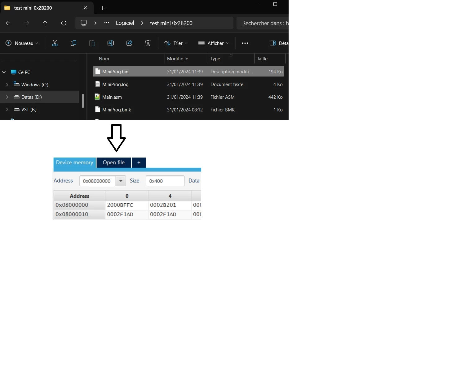

"Small"  one

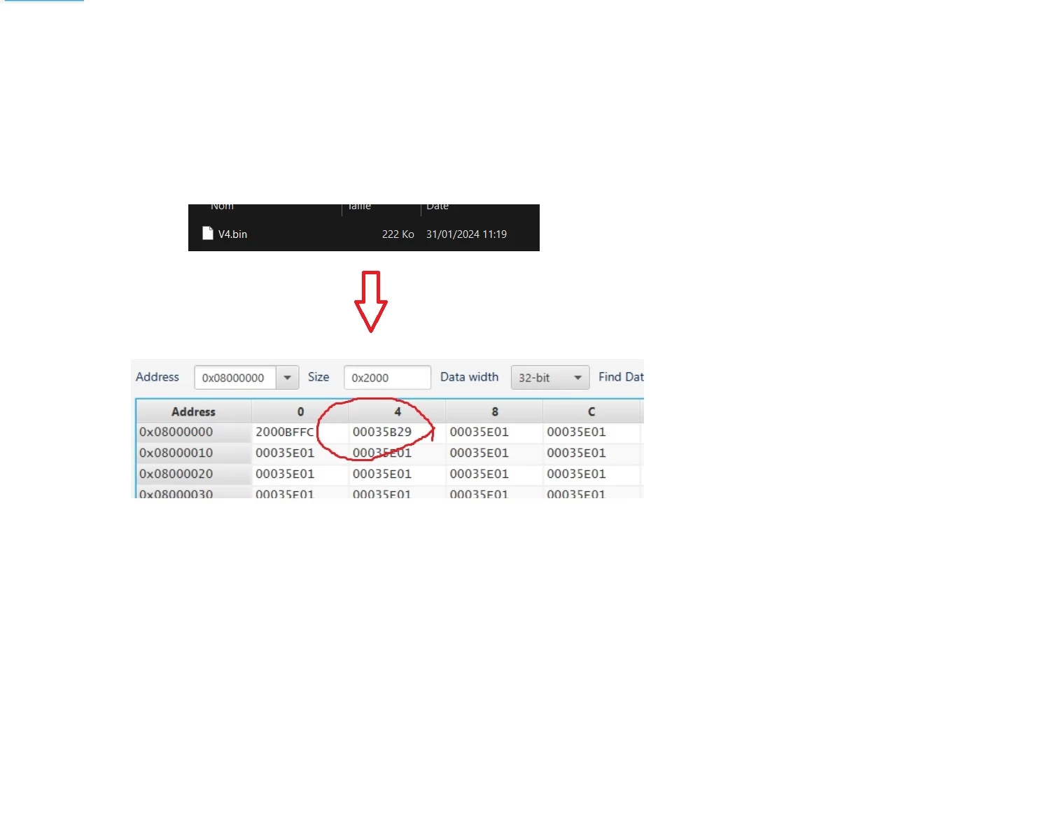

Bigger one, at the same adress

And big soft has about 50ko lenght (at always start at 0x2B200)

Sorry. Here the question :
I made a testing soft who start at 0x2B200
I notice than bin file has the (org address+1) at 0x04
That's OK and I used it for controlling file.
But when the file increase in size I noticed value at 0x4 was now 0x35B29   !
What can I do for this ?
Why do you want to do something about it? What problem is it presenting?
That is the location of Reset_Handler within the binary.

January 31, 2024
I don't understand why the value matters. The calculation is the same. (value at 0x04 - 1).

0x35B29-1=0x35B28, not 0x2B200

What makes you think it should be 0x2B200 ?
