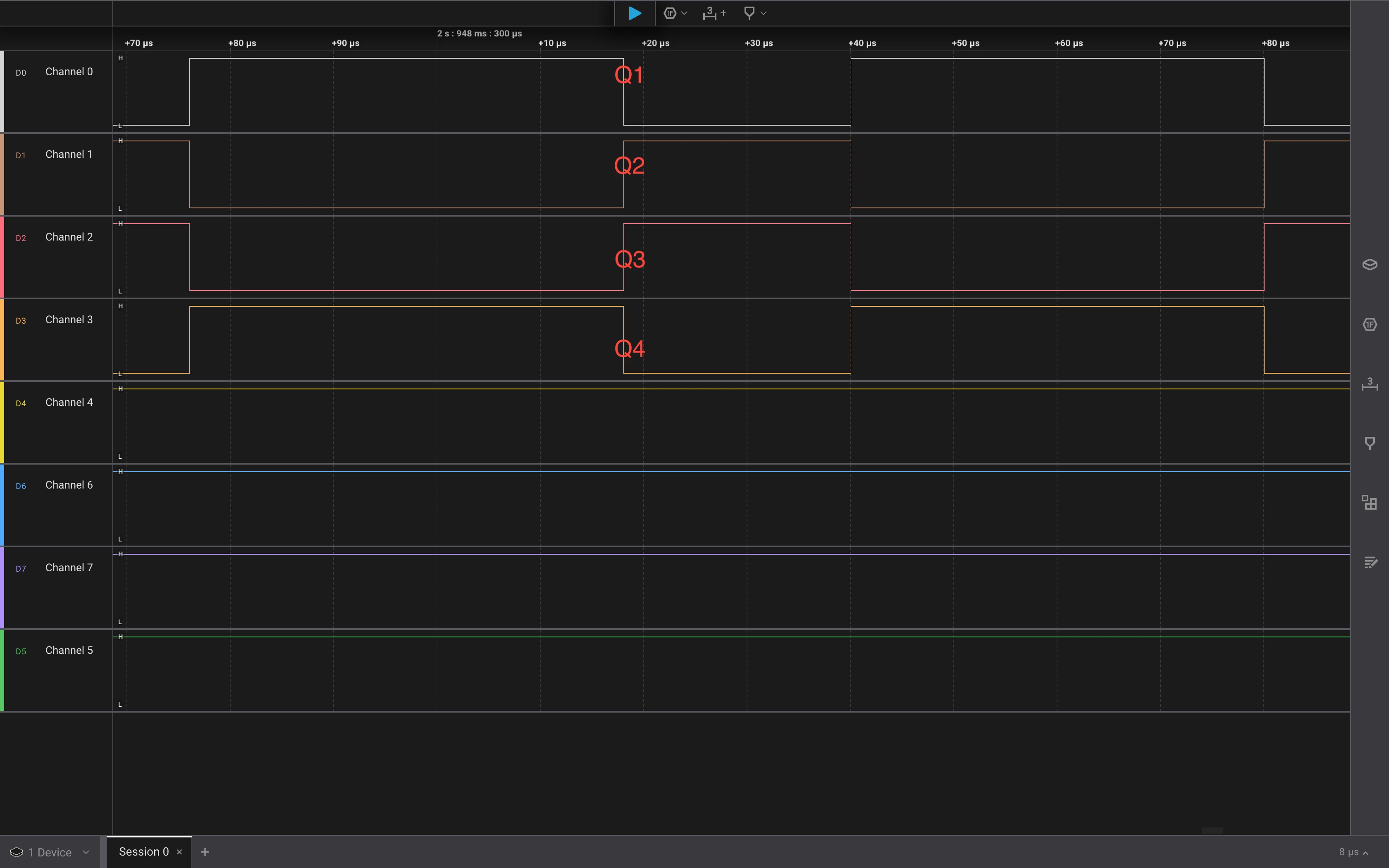

STM32 based H bridge driver ,One of Low side Mosfet gettinng heat slowly all others are cool
Drivinng ann H bridge to generate a sinewave , PWM generated and driving the H bridge .The PWM siganl as follows

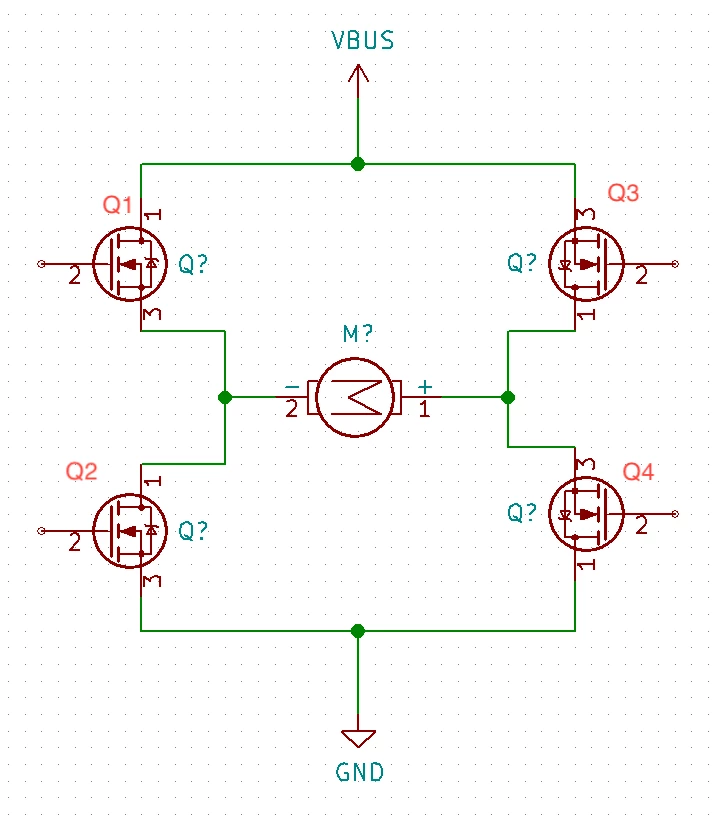

The H bridge Connection as shown below.
While appling supply the Low side MOSFET Q2 is Heating up Why so ?
I added some dead time also nothing happen .

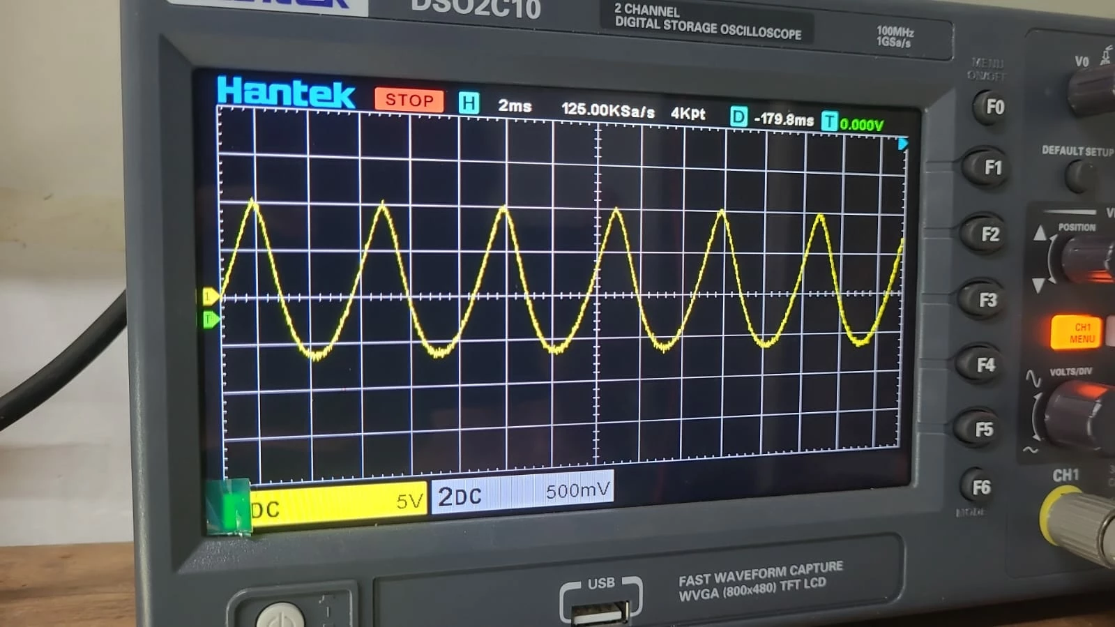

I interchanged the H bridge  PWM signal as functioning as Q2 siganl is properly changed to Q4 ,Now the Q4 is heating .
Also get a half sinewave shape little like a sharp peak like a triangle waves .
see the sinewave  below
what wrong am doing ?
