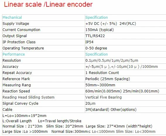

Hi everyone,
I need to reed a quadrature encoder signal from a sensor, modify the number of pulse and send this signal out to a machine.
The output signal must be a TTL quadrature signal, I have 5 pins: 0v, 5v, A, B and Z on my machine.
All the reading part is OK but I don't know how I should do for sending exact amount of pulse with quadrature signal.
Thank you for your help

I'm not sure I'm allowed to put commercial link on this forum
Here are information that I have

Your title is wrong. You need quadrature encoder input, so a quadrature decoder!
Any two channel STM32 timer can act as quadrature decode. Read the reference manual and the timer cookbook about that.
