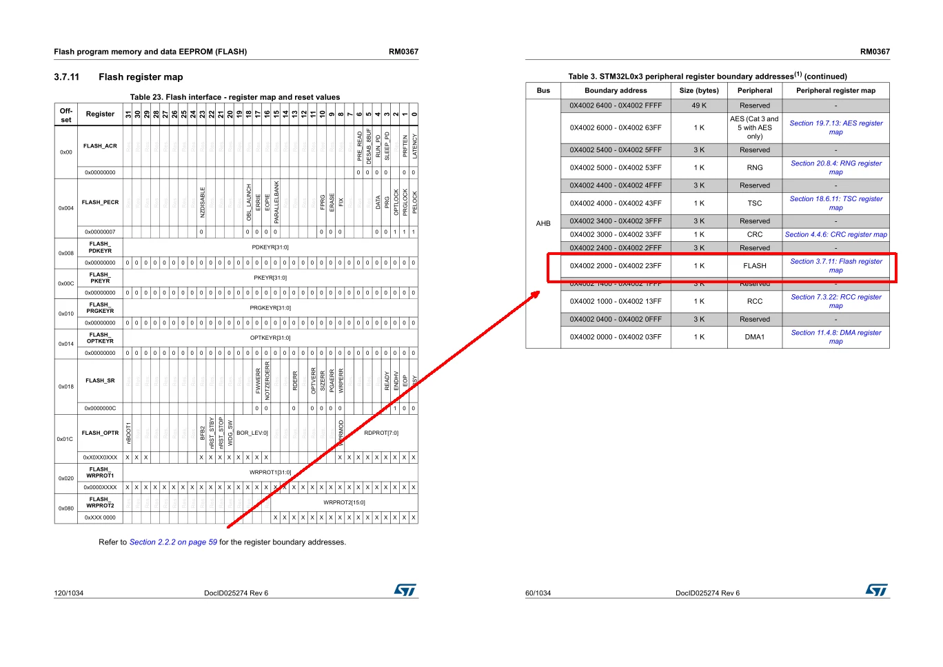

I have a question regarding STM32L0. I am interested in which address the registers like FLASH_ACR, FLASH_PECR, etc., are located. In the datasheet, I only see their offsets, but not the absolute value is it maybe 0x1FF8 0000?.
Also I would also like to know if it is possible to read from the mentioned registers like FLASH_SR, etc., when the MCU is locked at Level 1? Because to unlock it (using an external debugger).
Why all this? I want to erase mcu no matter if it is or is not in Level1 or Level 0.
Thank you Jan.

Have you checked the Reference Manual for your stm32L0?
For stm32l0x1 for example, it is stated in section 2.2 "System and memory overview:Memory organisation"
Table 3. STM32L0x1 peripheral register boundary addresses(1) (continued)
RM0377
Bus
Boundary address
Size (bytes)
Peripheral
Peripheral register map
NVM
0X0800 0000 - 0X0802 FFFF
up to 192 K
Flash program memory
0x0808 0000 - 0x0808 17FF
up to 6 K
Data EEPROM
0x1FF0 0000 - 0x1FF0 1FFF
8K
System memory
0x1FF8 0020 - 0x1FF8 007F
96
Factory option bytes
0x1FF8 0000 - 0x1FF8 001F
32
User option bytes
1. Refer to Table 1: STM32L0x1 memory density, to Table 2: Overview of features per category and to the device datasheets for the GPIO ports and peripherals available on your device. The memory area corresponding to unavailable GPIO ports or peripherals are reserved.

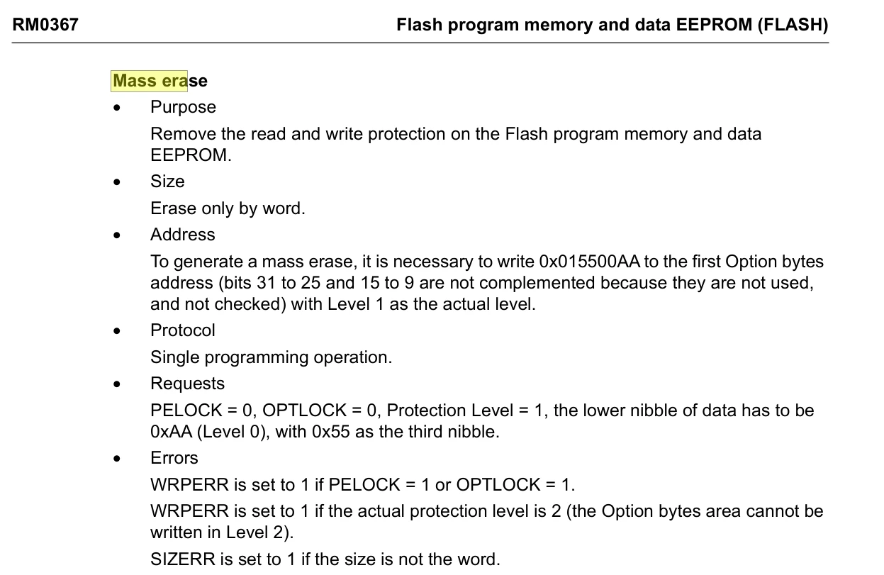

This is exactly what I was looking for, Unfortunately I still can not make mass erase of my MCU. I found this: It should erase MCU when is in Level1
So I made it
RDP_UNLOCK = 0xAA
PRGKEY1 = 0x8C9DAEBF
PRGKEY2 = 0x13141516
PEKEY1 = 0x89ABCDEF
PEKEY2 = 0x02030405
OPTKEY1 = 0xFBEAD9C8
OPTKEY2 = 0x24252627
SECTION_USER_OB = 0x1FF80000
FLAHS_OB_BASE = 0x40022000
FLASH_PECR = FLAHS_OB_BASE+0x4
FLASH_PEKEYR= FLAHS_OB_BASE+0x0C
FLASH_OPTKEYR = FLAHS_OB_BASE+0x14
FLASH_OPTR = FLAHS_OB_BASE+0x1C
FLASH_PRGKEYR = FLAHS_OB_BASE+0x10
FLASH_SR = FLAHS_OB_BASE+0x18
def massErase(self):
 self.unlockOptionBytesArea()
 self.programoptionBytes(0x00AA)
def unlockOptionBytesArea(self):
 self.busy_wait()
 tmp = self.readU32Mem(FLASH_PECR)
 if (tmp & PECR_PELOCK_BIT) == 0: #
 if tmp & PECR_OPTLOCK_BIT == 1 :
 if self.writeU32ToMem(FLASH_OPTKEYR,OPTKEY1) == True:
 if self.writeU32ToMem(FLASH_OPTKEYR,OPTKEY2) == True:
 self.busy_wait()
 return True
 def programoptionBytes(self,val):
 val = self.option_bytes_word(val)
 self.writeU32ToMem(SECTION_USER_OB,val)
 self.busy_wait()
 flash_sr = self.readU32Mem(FLASH_SR)
 if flash_sr & SR_EOP != 0:
 self.writeU32ToMem(FLASH_SR, SR_EOP)
