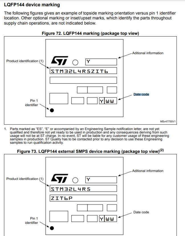

Rclar.13 what is the date code of the CPUs that are falling for you?

Hello NVand.1 . This sound similar to me I was using a SMT32L4R5ZIT. The voltages at the ADC inputs are as expected but the readings are saturated. As you have mentioned replacing the cpu does fix it.
I am not sure how to find out the date code.

0693W000008yXl7QAE.pngBy the way, are you using the one with the external SMPS?
