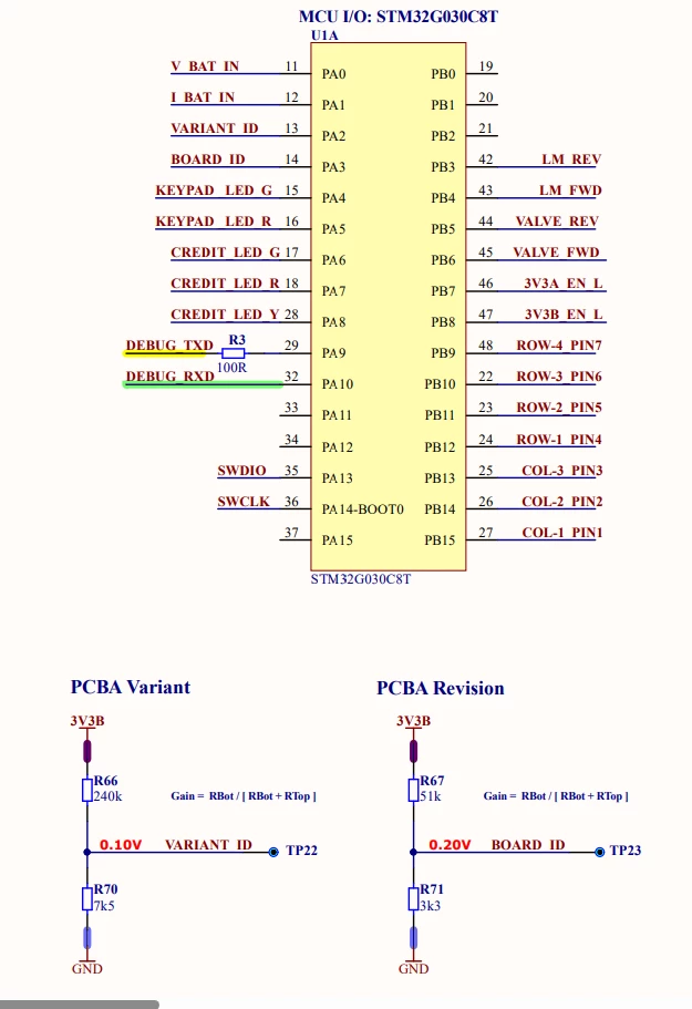

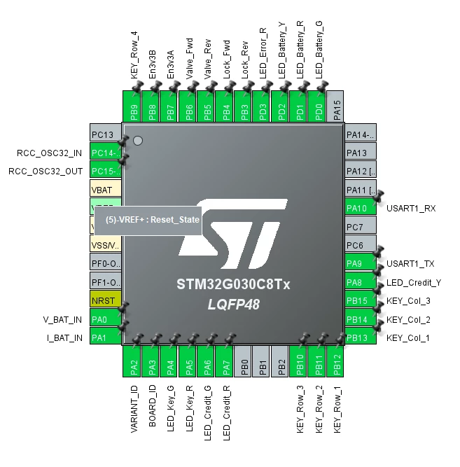

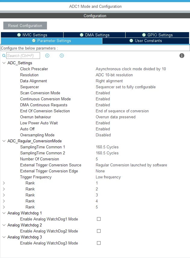

I am experiencing the following problem. When I setup an ADC with DMA for 5 channels, occasionally I get lower readings than the expected ones. It also happens in some of our hardware of our production, but others perform ok. We have inspected the components and everything seems identical. We have measured the reference voltage and all the expected voltages on ADC input pins (some are fixed and known) and all looking good too. On the other hand, when I sample only one ADC channel in polling mode, I do not get this problem, the voltages read as expected.
Here is the ADC configuration with DMA (source code attached too):

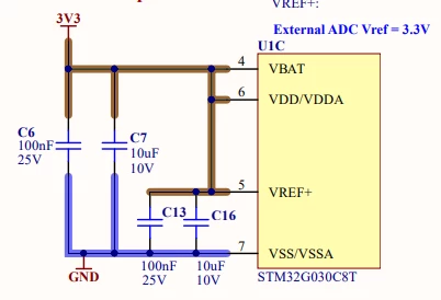

How is VREF+ connected?
KoStAuthor
March 29, 2024
The Vref+

I have posted the source code, the cube mx configuration, the schematic, the test results. Am I missing something?

Common denominator of many ADC-related problems is too high signal impedance/too short sampling period, crosstalk/interference (often related to improper grounding/return arrangement), unstable reference.

You've said that the problem is with battery voltage measurement, yet you're showing schematics for measurement on a divider not related to battery.

I said that the problem is with all the ADC channels and I used the battery voltage as an example to answer your question with some measurements.

Wrong gain may be caused by different-than-expected VREF+ voltage.
What are the VREFINT readings for the problematic devices?
