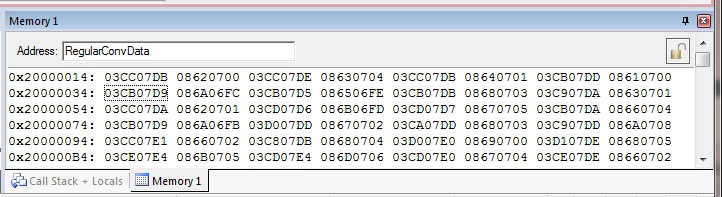

I am working with stm32F0 ADC & DMA peripherals and i have to convert 4 channels.The ADC  is triggered by the Timer1.
My problem is that i obtain  the result correct but there is a permutation between  2 channels(the second & the 4th).
So is any one have an idea to help me resolve the problem.

    It's scanning backward, does that impact your expectations?

    Doing a quick validation on a STM32F0-Discovery, it looks to me like a TIM1 paced ADC of 4 Channels using DMA appears to generate consistent results for all 4 channels, across a large circular buffer.
    One potential road block would be if the TIM pacing exceeds the conversion rate of the ADC.

    esraf posted a similar, but not identical, problem on this forum 1/2/2013. Martin D replied that when the F0 ADC is calibrated, DMA advanced one position forward in the memory buffer. Go read esraf's post and see if that helps in understanding. And check the errata for your processor version to see if this is mentioned.

    Thank you very match ,the problem was resolved.Just the calibration must be done before the DMA initialization to avoid the DMA memory increment.
