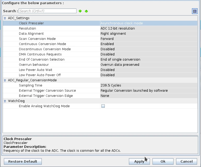

    yes, the values go crazy down here;
    ADC_CLOCK_ASYNC_DIV1
    and   ADC_SAMPLETIME_1CYCLE_5
    what sample time are you using ?
    you really have to calibrate the ADC too, if you want some accuracy in the readings

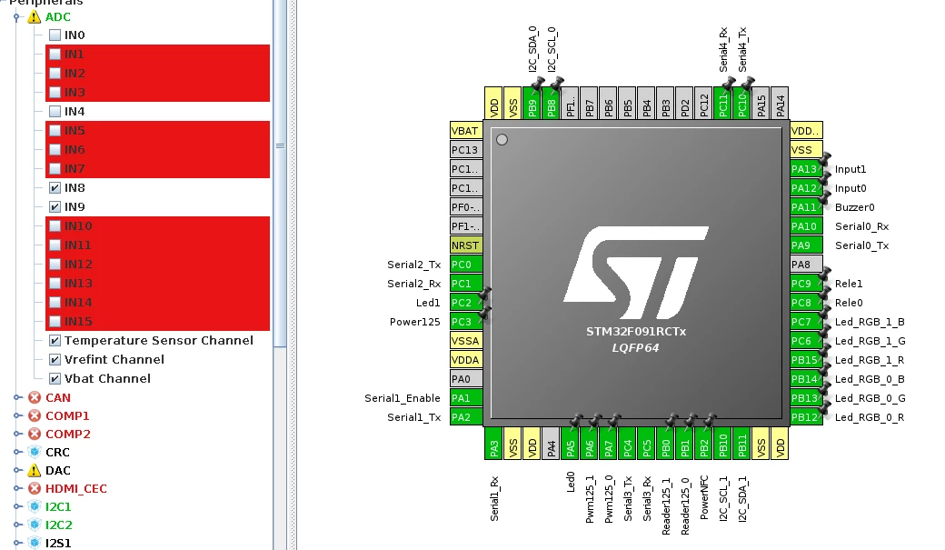

    Denis Gottardello
    January 20, 2018
    Posted on January 20, 2018 at 09:35
    Finally this is my CubeMX setup
    This is my callback
    unsigned int ADCValues[5];
    unsigned int ADCIndex= 0;
    void HAL_ADC_ConvCpltCallback(ADC_HandleTypeDef *hadc) {
        if (__HAL_ADC_GET_FLAG(hadc, ADC_FLAG_EOC)) {
            ADCValues[ADCIndex]= HAL_ADC_GetValue(hadc);
            ADCIndex++;
        if (__HAL_ADC_GET_FLAG(hadc, ADC_FLAG_EOS)) ADCIndex= 0;
    And outside che callback I check the ADCValues[2] and ADCValues[3] where I should have the Temperature and Vdd values.
    Is this the right approach? The Temperature value now seems to be ok.
