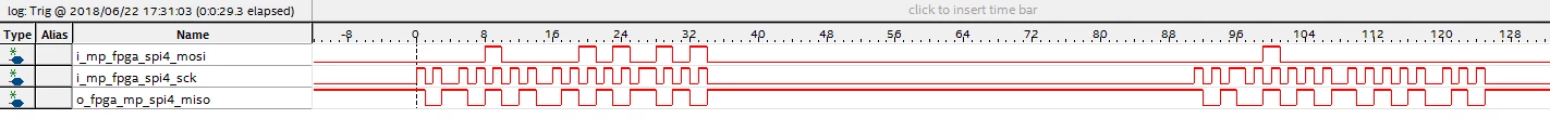

    We have generated the software code from STMCube for System32 workbench. We are using this command to read/write to SPI :
    >HAL_SPI_TransmitReceive(&hspi4, (uint8_t*)spiTxData, (uint8_t*) spiRxData, 2, 5000).
    >STM32 is spi master and an FPGA is SPI slave. For the first transaction, we are able to receive the data sent. But if I call the same function again the SPI clocks and data transmitted is not as expected.
    PS:Attaching chipscope/signal tap images captured.0690X0000060LKKQA2.png0690X0000060LNcQAM.png

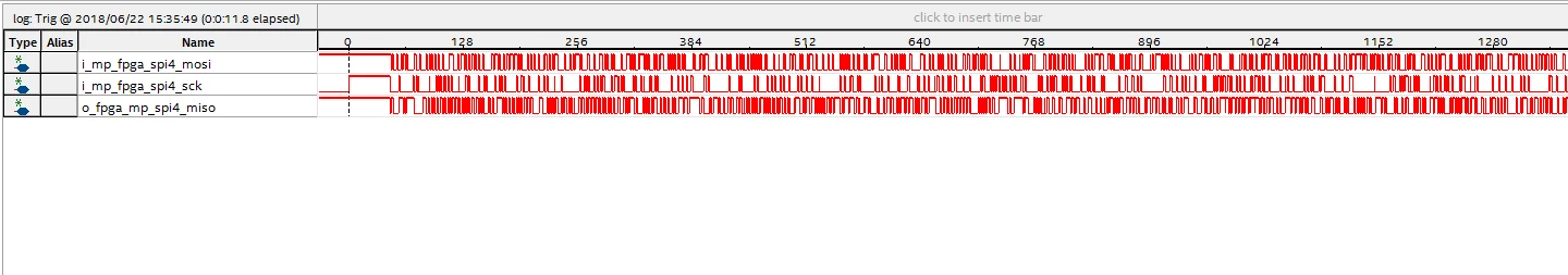

    Hi Clive,
    Thanks for the reply.
    By ''Expected'' I meant as ''the first SPI transaction'' that I am observing after power on.0690X0000060LUiQAM.png
    If insufficient bandwidth is the reason causing the issue, then why not we are facing the same for the first transaction?!

    David Littell
    Senior II
    June 27, 2018
    Posted on June 27, 2018 at 15:08
    It's not that insufficient chipscope bandwidth is the issue, it prevents seeing anything helpful.  There are hints of a scope bandwidth problem in your first trace but the second one isn't helpful at all because of the compressed time scale and the lack of bandwidth.
    Have you tried isolating (disconnecting) the FPGA SPI signals to see what the second transaction looks like without the FPGA?  If the second transaction suddenly looks more reasonable you have problem in the FPGA.  Otherwise you have a STM32-side code problem (my personal suspicion).
