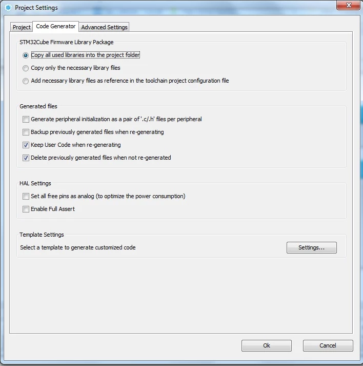

    Hi Denis,
    If your using CubeMX, under ''Project Setting'', select the second tab and make sure the radio button is on ''Copy all used libraries into the project folder''.
    All the files for the LL Libraries are now in the [''You're Project Folder''\Drivers\STM32F0xx_HAL_Driver\Src] and
    \Drivers\STM32F0xx_HAL_Driver\Inc] folders upon code generation in CubeMX. The src folder houses the .c files while the Inc folder contains all the .h files. Add the
