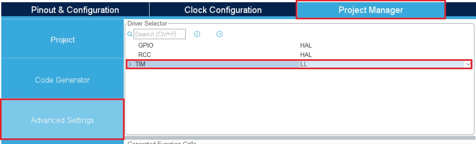

It seems that CubeIDE can use the LL library to generate TIMers in Encode mode?
KDJEM.1
April 6, 2023
Hi @YLi.13​ ,
Yes, you can use the STM32cubeIDE to generate Tim_Encoder project with the LL library.
After configuring your project with STM32cubeIDE, you can click at project manager/advanced settings and choose to use LL drivers in driver selector as shown in the below figure.
_legacyfs_online_stmicro_images_0693W00000bhfSoQAI.pngDoes it answer your question?
