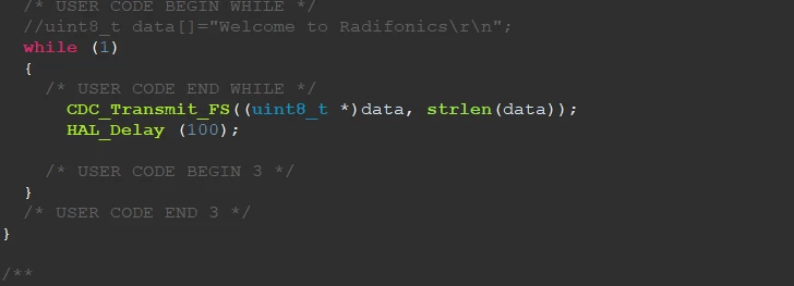

Dear ST Community,
I'm using Windows 11 on my PC but the device manager doesn't detect the STM32 USB VCP. Please help me fix this issue.
best regards
Neeraj

I am using CDC Lib for sending messages.

Please use this button to properly post source code - not as images:
Does anything happen at all on the PC when you plug in? eg, does it see any "unknown" device? or report any error?
Presumably, your embedded code should also detect when it's plugged in - is that happening?

So what about the STM32 end?
What debugging have you done to see what's happening there?
