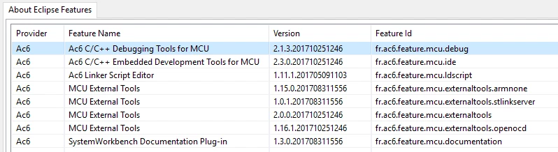

  • Installed toolchain which creates the elf file (attached):
  • used STM Studio version: 3.5.1

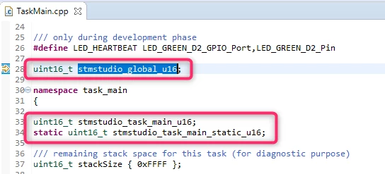

    Most of the modules are programmed in c++ using namespaces.
    It seems that variables in namespaces are not supported:

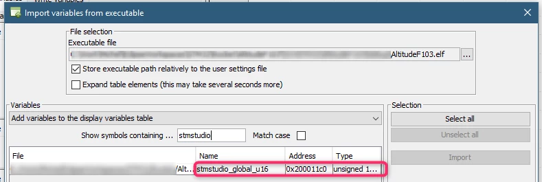

    Here is an example (each test variable is used in the code to prevent  a deletion due to optimization)
    only the variable outside the namespace is available:

    You are right, I confirm there is also an issue with C++ namespaces. See also
    https://community.st.com/0D50X00009XkYHESA3
    In the elf file you posted, I mainly saw const variables defined this way, for which gdb is not able to find an address; so I'm even wondering how the linker is managing them ? Do they appear in the map file ? They are perhaps embedded in the code itself (where used), without any address information in the elf file.
