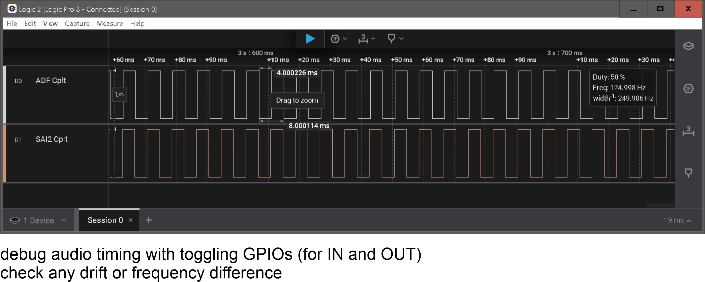

I want to get audio from an INput source and forward to an OUTput sink. And both should stay in sync "forever" (I do not want to have a clock drift, I do not want to have the condition to skip a sample or to add one, just because of a slightly different timing (different clock frequencies)).
My use case:
STM32U5A5 with ADF for a PDM MIC as INput and SAI2 as SPDIF OUTput.
I use 48KHz audio Fs (PDM MIC is with decimation 64, so 3.072 MHz PDM MIC clock).
ADF runs in DMA mode (cyclic double buffer) but SPDIF (SAI2) runs in INT mode (single buffer).
This means: the ADF fills seamlessly the result buffer, without any software overhead, but the SAI2 as SPDIF out needs all the time periodic interrupts and the callback called and restarting the next INT.

The debug was this:
  • toggle two GPIO output pins: one in the callback for the INput process and another one in the OUTput process
  • compare (display) both with a scope
  • and I got two pulse trains which where drifting: not the exact same frequency! "Not locked".
I saw:
  • the INput (ADF) was slightly faster as the OUTput
  • the pulses were permanently drifting in relation to each other ("not locked")

Next step: how large is the "drift" (frequency offset)? It was very small (not in the range of a divider). Just for a test I tried this:
Make the buffer for the ADF (PDM MIC input), which was a bit faster, a tiny bit larger (one sample more). And what a surprise: now they GPIO test signals were locked! Perfectly in sync, no drift anymore.
But: "why do I need one more sample for input to make IN and OUT in sync?" And it is not really nice, because I had to skip one sample from IN, the OUT is not really seamless anymore.
"Hmmmm, scratching my head..."
I came up with this suspicion: the OUT runs in INT mode: on every callback I have to kick off again the INT.
But this function call to do (see the HAL_SAI_Transmit_IT() done in the CpltCallback), takes time. There is maybe a gap in the seamless audio streaming, the next INT starts a bit too late. This causes my clock drift.
YES!!!! It does!
The drift in the debug signals comes from the SW overhead, the time needed to start the INT again.
How to fix?
"Hmmm, start this callback and next INT a bit earlier, to make a seamless audio transfer".
Et voila: there is the FiFoThreshold, when the callback should be triggered. If this is set for "FifoEmpty" - it is potentially "too late" to get a seamless audio flow.
So, I have changed this:
 hsai_BlockB1.Init.FIFOThreshold = SAI_FIFOTHRESHOLD_1QF;	//SAI_FIFOTHRESHOLD_EMPTY;
This triggers the callback for the SAI2 (SPDIF out) a bit earlier. The SAI2 can still send a bit from FIFO but it I have time to restart the INT.
If I wait for _EMPTY - the call to start INT again has to be done (which takes time) - it creates a gap in the audio stream.
So, this FIFOThreshold changed has fixed the problem. Now, all runs fine and the "trick" with the slightly larger INput buffer is not needed anymore. I was right at the edge, that the output was one sample too late and setting the trigger a bit earlier has solved the problem.
