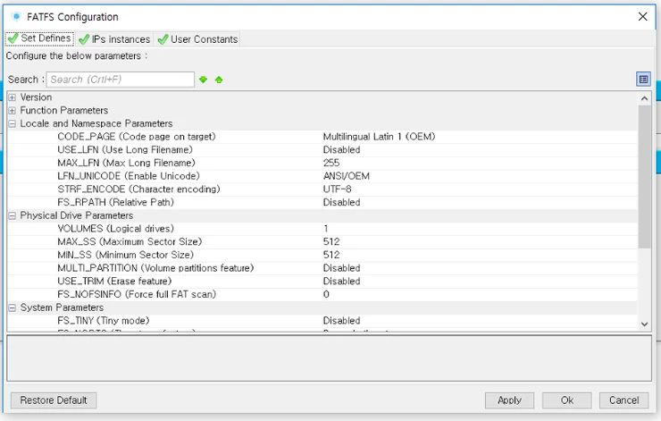

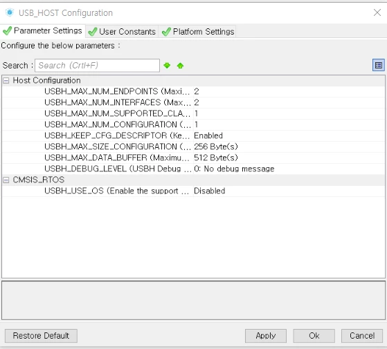

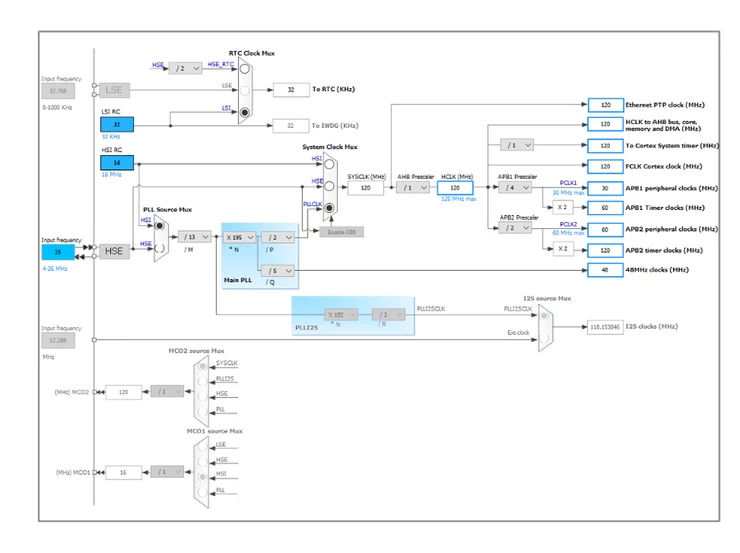

Hi mass storage is being implemented.
Nucleo-F207G is being tested.
en.stm32cubef2 \ STM32Cube_FW_F2_V1.7.0 \ Projects \ STM32F207ZG-Nucleo \ Applications \ FatFs \ FatFs_USBDisk
The sample is usb-detectable without any problem, and the txt file can be written well.
If you design code with cube as below, you can not detect usb.
0690X00000608wWQAQ.png0690X00000608suQAA.png0690X00000608wlQAA.png0690X00000608wUQAQ.png0690X00000608wvQAA.png0690X00000608tOQAQ.png0690X00000608x0QAA.png

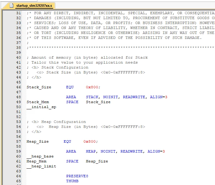

If you create a project with cube, you have to change heap / stack size.

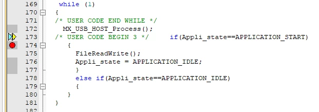

Appli_State value should be recognized as 1, even if you connect usb stick, it is still 0;

while (1)
  /* USER CODE END WHILE */
    MX_USB_HOST_Process();
  /* USER CODE BEGIN 3 */     if(Appli_state==APPLICATION_START)
       FileReadWrite();
       Appli_state = APPLICATION_IDLE;
       else if(Appli_state==APPLICATION_IDLE)
