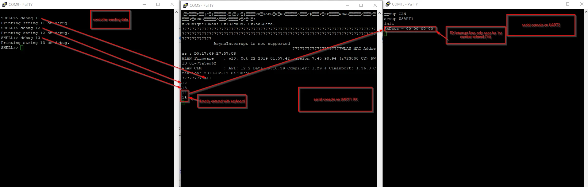

Unfortunately I only get interrupt if I enter chars directly in serial console window but not if chars are sent over serial line (see attached picture, left serial console of cable connected to UART1 input pins, right: serial console of UART2 output port for debug printfs).

Not exactly sure what the picture illustrates, but the printf() under interrupt context is not buffered and will block input for a dozen character times. Probably Ok for a human expecting it, less so for a machine blasting a string of characters at the input.
Check for and clear overrun or similar error status.

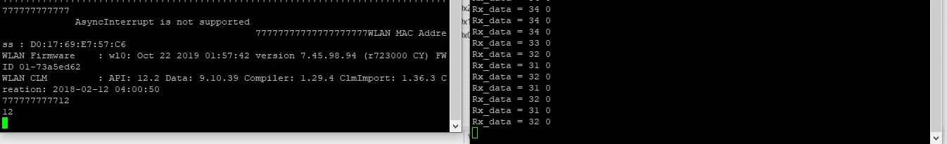

What I suspect is some difference between serial line input because if I send data from other microcontroller to STM UART1 input, I can see the data if I directly connect serial cable to RX pin (PA_10) (see screenshot below Putty windows: COM9 - serial console from controller that sends data, COM5 - serial console from cable directly connected to STM UART1 input pins (PA_9, PA_10), COM15 - serial console from cable directly connected to STM UART2 output pins (debug/printf redirection)).
It can be seen that UART1 RX interrupt fires once when directly entering data in Putty COM5 window, but never when data comes from other controller (debug xx commands on the left).

Show us, how do you have connected things electrically. To me, it sounds that you are trying to tie together two transmitters. Observing signals using oscilloscope would be revelatory in such cases.

Still not clear if you're checking the UART for error/fault status
There's unbounded array indexs in the handler, and I don't see these being initialized. Should perhaps start by just echoing back the returned characters, directly, not in the array you subsequently create.
It could just be that it isn't receiving anything properly, there you'd need to look at the physical plumbing, levels, pin configurations, etc. Diagram your system, circuitry, or connectivity.
The STM32 is using CMOS levels, not RS232. Different boards, or MCU, would need a common ground.
