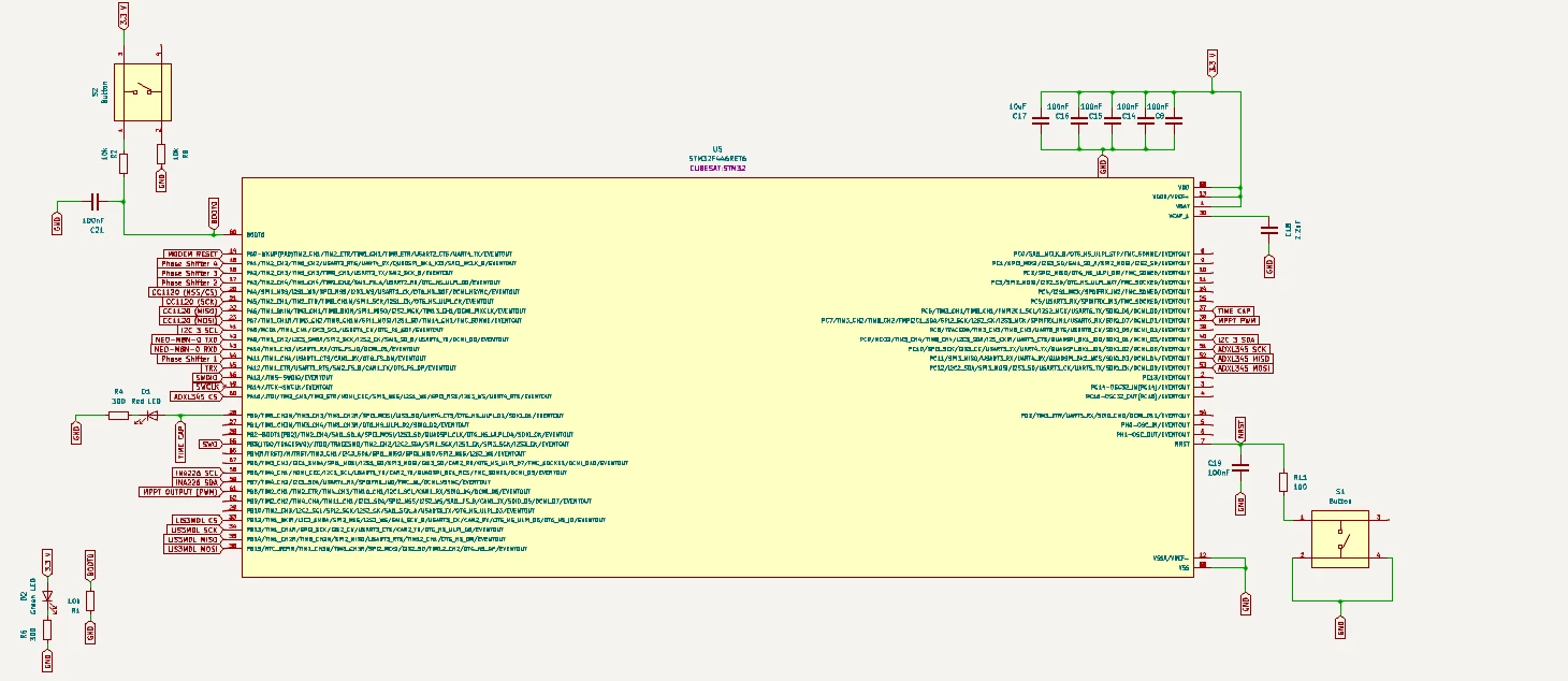

I have a 6 pin 01x06 pin male connector on the custom board for SWD, which connects to the appropriate pins on the STM32. Here is the board connection schematic:
Hopefully the image is visible.

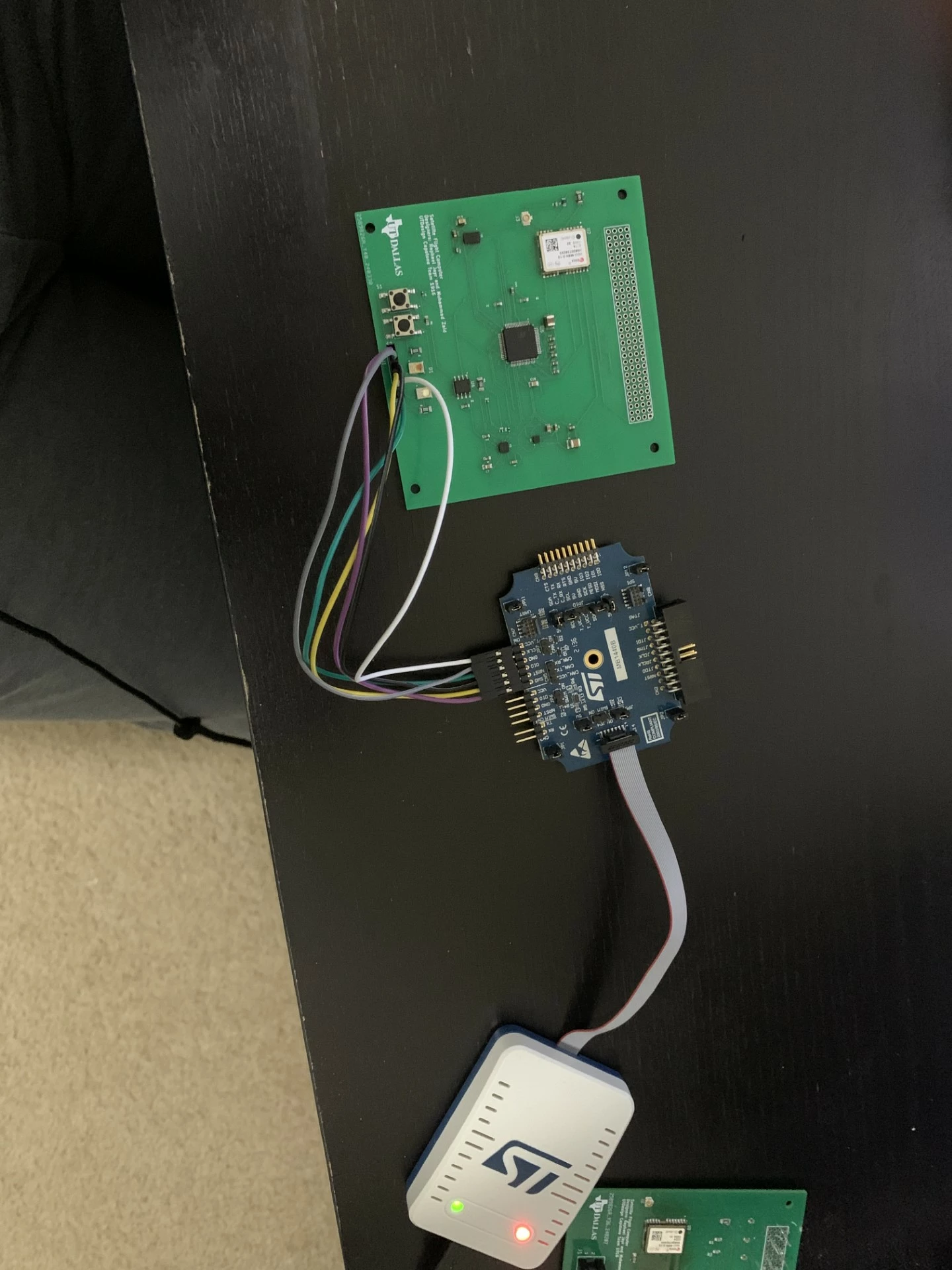

None of these work for me. I will also add a picture of my HW setup rn:
I dont understand whats the cause for this problem. Any help or advice would be much appreciated!

I might be the dumbest person alive (atleast from what I have read online :) )
You need to provide the STM32 with your own external power, the STlink SWD Vcc connection doesnt power the board  itself!

I added an external source, and tried again but this time the init failed:
Heres the error message:

This might be hardware issue but I cannot tell
April 12, 2024
NRST is getting voltage (~3.3V) so its driven high
The STM32 Chip also has a constant 3.3V on the VDD.
Cant figure out why the OpenOCD or STM32CubeIde cant find target.
