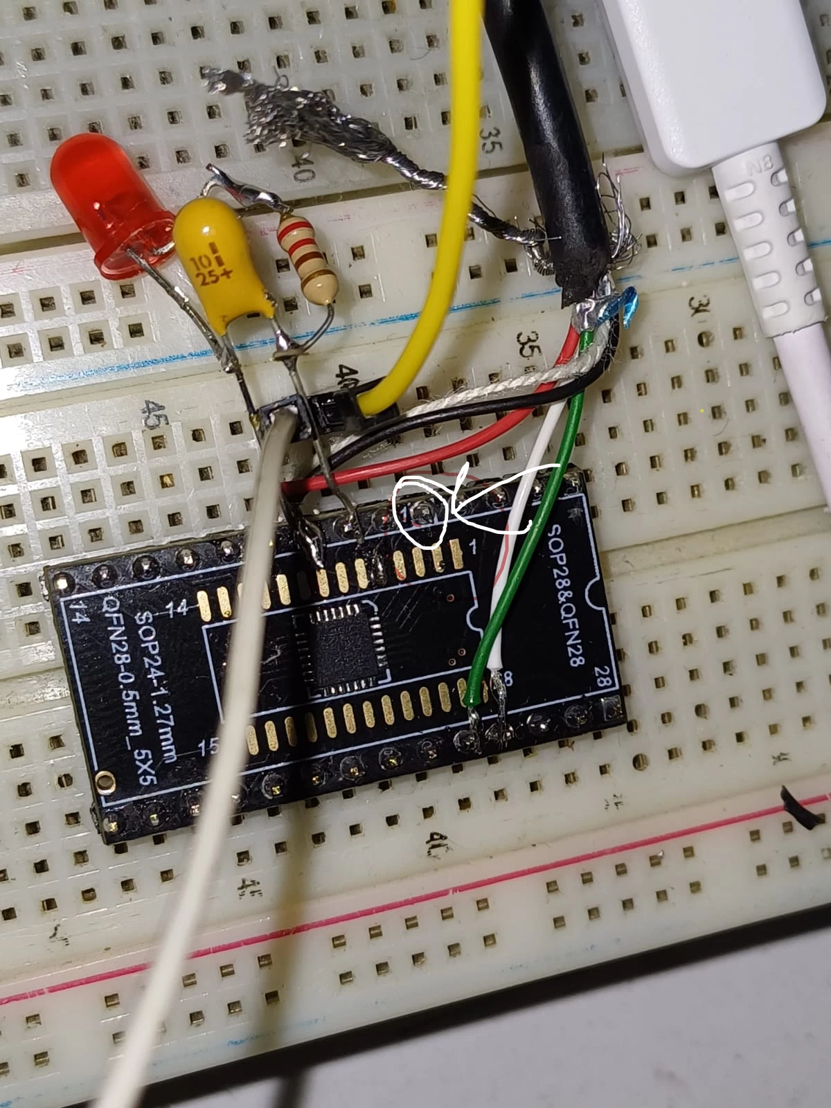

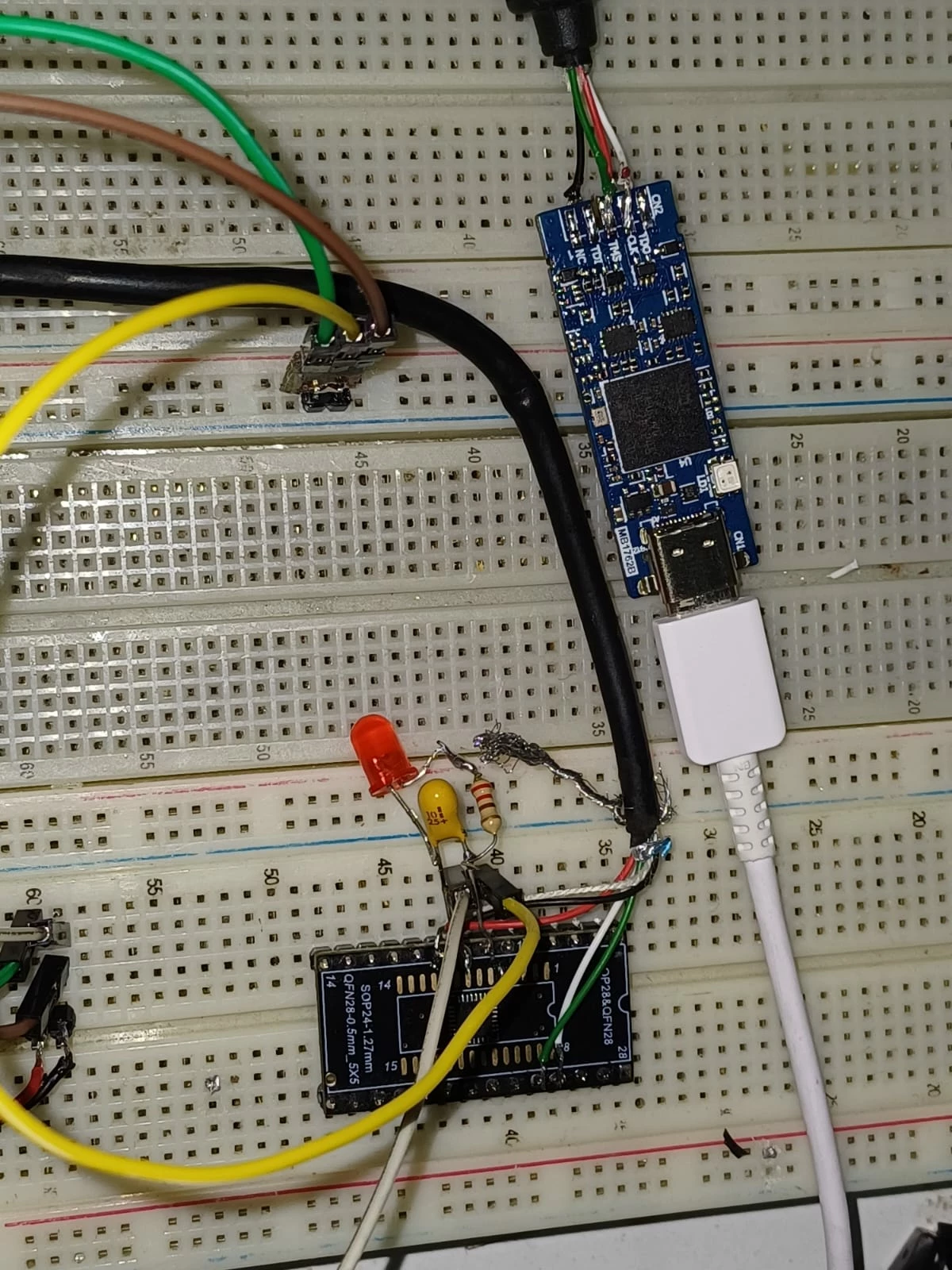

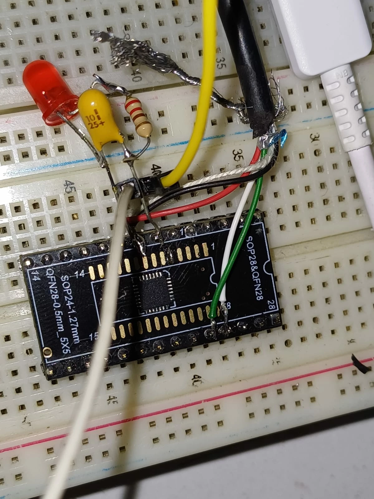

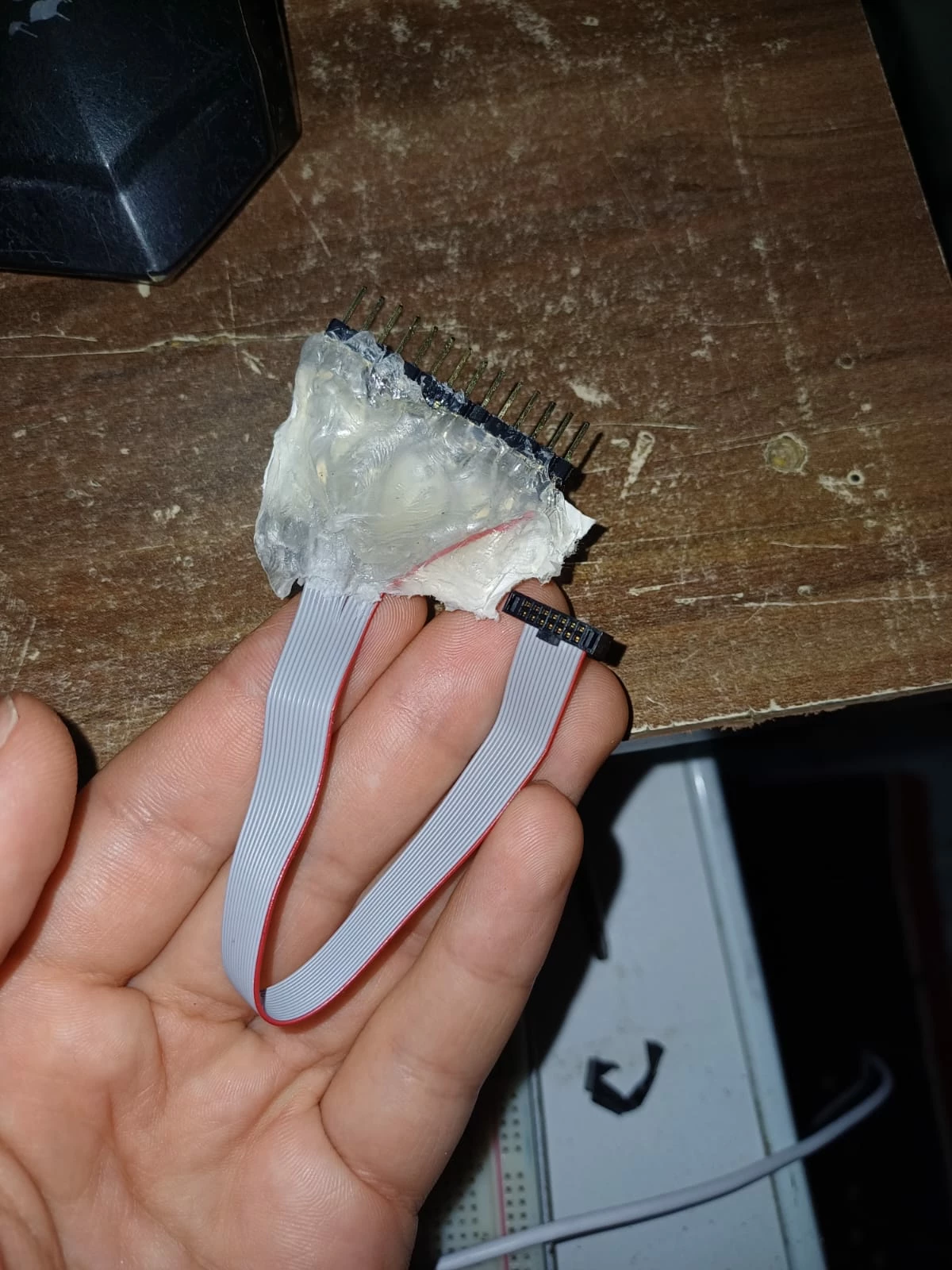

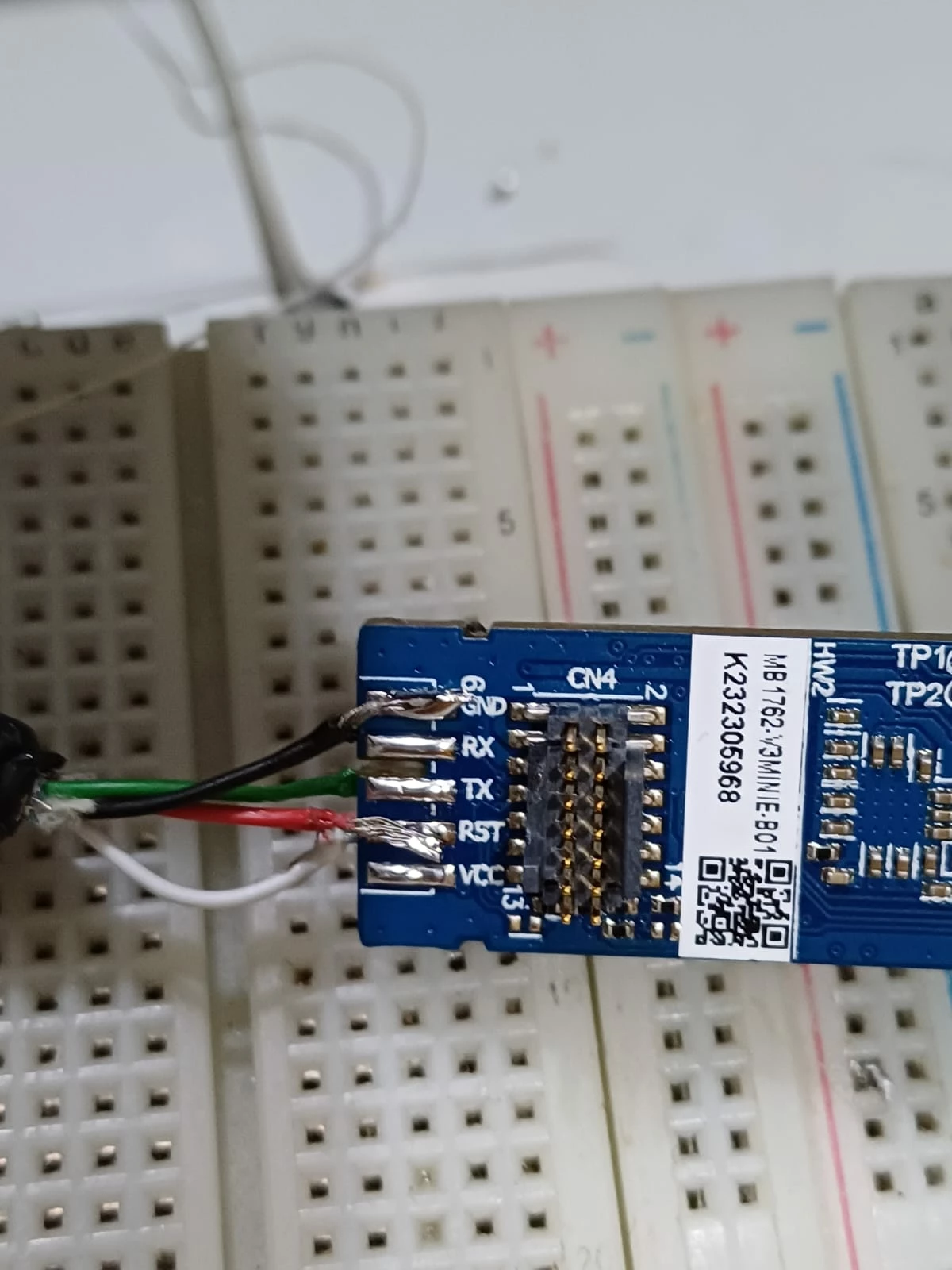

i have a stlink v3 mini and 3 stm32c031g4u6 microcontrollers soldered to proper breakout boards.

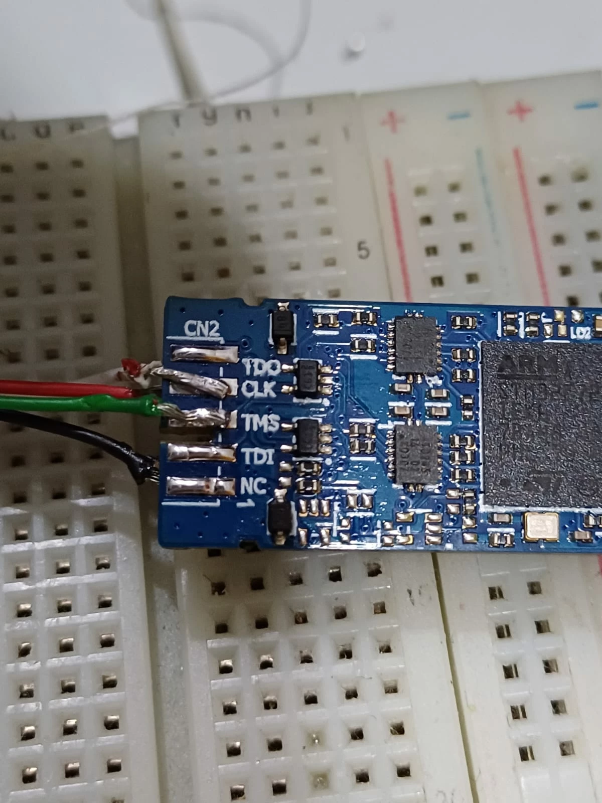

i have SWD interface soldered from the edge connector because i had no luck with cn4.
SWDIO, SWCLK and RESET are connected. i also have an led soldered to power pins to be sure its powered.
i am sure of the soldering job.
on my first post someone recommeded i solder capasitors so i did that still no result.
i am using linux mint's latest and the code i am trying to upload is just empty machine generated code

January 13, 2024
i have managed to narrow the issue to my stlink v3 minie. i went and bought a new stlink v2 mini and it works with cubeprogrammer with the current correct wiring. it appears that i have either fried the v3 mini or dont know how to use it. either way cubeprogrammer and V2 clone works for now

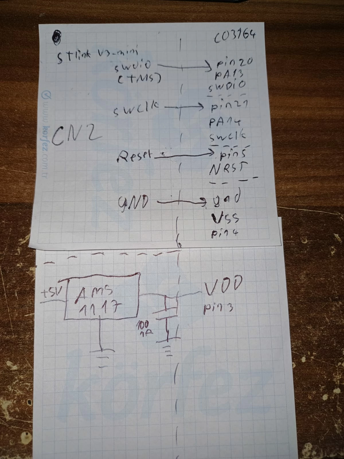

Perhaps a wiring diagram?
The error means your part is NOT VIABLE.
Generally that means an issue with power, make sure the VDD, VDDA, VSS, VSSA pins are suitably connected. Or things are just not connected to the right things.
The VCC on the ST-LINK may also need connecting if it requires VTARGET for any buffers. Does STM32 Cube Programmer report the voltage it sees?

i know. 3.3V is coming from ams1117.
here is the wiring diagram. i drew it quickly
if you wait a bit i can draw it in kicad but i have to install it

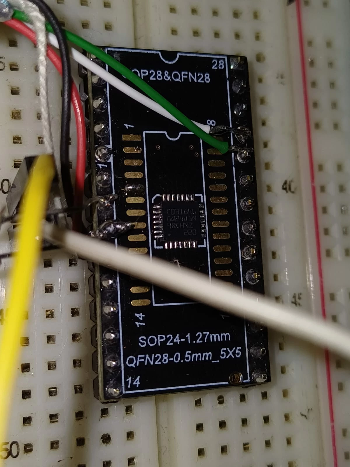

January 11, 2024

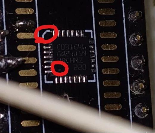

Part is oriented wrong based on the footprint. Pin 1 marking on the chip doesn't match pin 1 marking on the board.
oyalç.1
oyalç.1Author
January 11, 2024
that is pin one not the one next to it

January 11, 2024
Wiring still looks wrong if the IC is still rotated 90 degrees or 7 pins
Draw a chart, probe continuity and confirm where pin 1 exits
