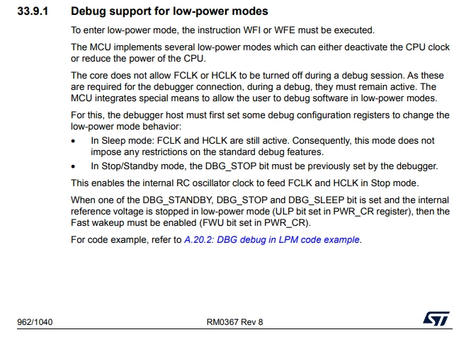

Hi everyone,
I have a problem, let's see if someone can help me...
I have a board that works with an STM32L053xxxx, my application, at a certain point, enters stop mode. Here comes the problem, the emulator disconnects.
Is there any technique or emulator that allows me to continue the emulation even in stop mode?

See section 33.9.1 in the Reference Manual:

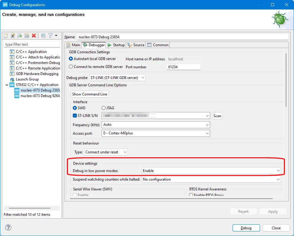

Also, if you're using STM32CubeIDE, enable debug in low-power:
And make sure that your application doesn't disable the SWD pins during sleep ...
davide_mpAuthor
May 7, 2024
HI,
Thanks for your reply, now I know it's somehow possible.
I could still use your help, please.
I use Keil uVision 5 and an STM32L053C8T6.
It's not like you know how to set up the debugger, at the moment I use a simple ST-Link Debugger V.1.
I don't understand if it is possible to program this to work or I have to use other debuggers.

Andrew Neil
May 7, 2024
I can't even visualise what an ST-Link V1 looked like!
How old is it?
The features mentioned in section 33.9.1 of the Reference Manual are internal to the chip - so shouldn't be restricted by what debug probe you use ...
You'd have to ask Keil what is their equivalent of the  STM32CubeIDE's "enable debug in low-power" feature:
