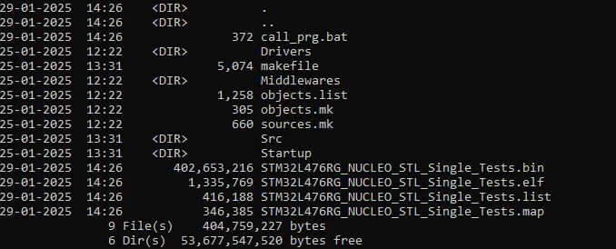

Bin file snippet of STL project for Nucleo – L476:
Bin file size is 393MB, this is huge, we can’t bootload this file using Bootloader App. It should be in KBs.

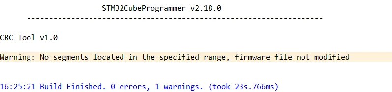

And we are getting below warning after build
Kind regards,

The commas also look very oddly placed. Show a DIR from a DOS Box or File Manager
Large .BIN files typically occur due to large discontinuous sections in a .ELF file, or .HEX
BIN files can't have VOIDS in them, and must describe all space between the beginning and ending addresses.
Inspect the .ELF with tools like OBJCOPY, OBJDUMP, FROMELF, etc, you're likely outputting data into RAM spaces or EXTERNAL MEMORY, which wouldn't be appropriate to be in the .BIN

Hello Tesla,
Please see below snippet for debug DIR

I confirm, the STM32CubeProgrammer CLI (applied at the post build command) calculates CRC check sums for those flash segments occupied by code exclusively. The warning message signalizes that no code was detected at the range specified for the CRC calculations so the programmer has found nothing to modify.
