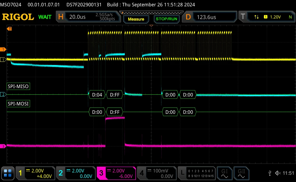

I'm having difficulty writing to STGAP1BS configuration registers.
I'm using a Nucleo -G474RE to communicate with STGAP1BS chip on a custom board through SPI bus.
Below I'm trying to configure CFG2 with the value 0xA0 but when I read back the register I get the default value of 0x04.
The STGAP1BS uses a 16-bit SPI, below is the setup for 8-bit SPI on the Nucleo board but I did try 16-bit data size as well although I might not be implementing it correctly.

STGAP1BS datasheet:
https://www.st.com/resource/en/datasheet/stgap1bs.pdf
Another issue is I'm getting the register value as the 1st byte of the reply but according to the datasheet it should be the 3rd byte in the reply. It's consistent when I tried reading all the other registers.
Below is an oscilloscope screenshot. It shows the CLK(yellow), MISO(blue), and MOSI(purple). I did confirm both CS and SD lines are being set correctly.
