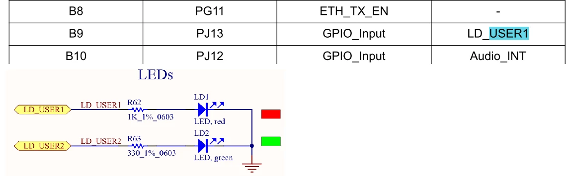

Dear community,
I am totaly new and trying to get some idea on STM32F7...board
I've got opened an example project, provied within IDE. If I compile code and download it to MCU, everything works fine: 2 LEDs are blinking:
This is the main code for LEDs blinking within main function:
while (1) {
   while (Buttons_GetState() & 1U);       /* Wait while holding USER button */
  osSignalSet(tid_Thread_LED, 1U);       /* Signal LED thread             */
  osDelay(100);                          /* Wait 500ms                    */
It does blink, when no button is pressed.
in order to get better understanding in MCUs I am trying to simplyfiy the code and change it in the following way:
 while (1) {
      if(mytempV %2 == 0){
      HAL_GPIO_WritePin(GPIOB, GPIO_PIN_9,GPIO_PIN_RESET);
      else {
      HAL_GPIO_WritePin(GPIOB, GPIO_PIN_9,GPIO_PIN_SET);
         mytempV++;
   osDelay(500);                          /* Wait 500ms                    */
I have expected that one of LED will start blinking. I checked in manual that red LED seets on Port B pin 9:
However, nothing was happening.
If I use
while (1) {
     HAL_GPIO_TogglePin (GPIOB, GPIO_Pin9 )
result is the same: nothing.
What could be the reason for that?
Shouuld I allow somwhere independently the GPIOs to be changed?
or I messed up with use of osDelay()?
Best regards,
Ivan.

B9 is the physical BGA package pin number. The PJ13 is the peripheral port and pin.

thank a lot for your answer. Indeed, I have tried to change to
     HAL_GPIO_WritePin(GPIOJ, GPIO_PIN_13,GPIO_PIN_RESET);
and it helped.
However, I am a bit confused by now with this "double naming" system for Ports and pins. I find it more consistent to adress directly pins as I learned it for Atmega8 about 15 years ago...
Thanks again.
Ivan.

The reason why we have "double naming" is the fact that the same silicon comes in different packages with different pin count.
https://protostack.com.au/wp-content/uploads/IC-ATMEGA8A-PU-3.jpg
Package pin 28 is PC5. How is ATmega8 different in this regard?

Its quite common to name BGA package pads B9 etc., whereas the port+pin combination applies to the internal die regardless of the package used.
