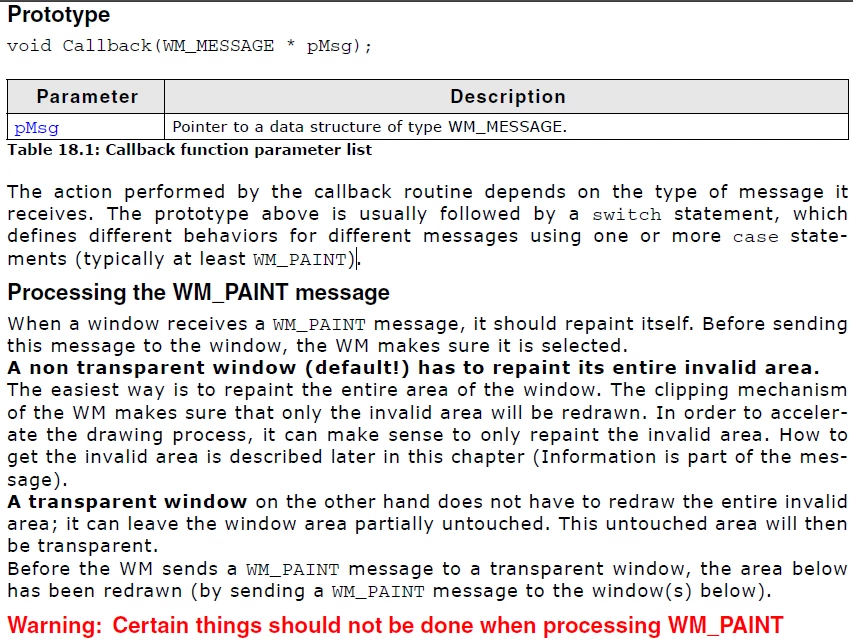

I am trying to use STemWin 532 on a STM32f467 board. I created a framewin with 4 buttons using GuiBuilder and ran the application, but the display is scrambled. This is how a framewin with 4 buttons looks like on my display :
https://drive.google.com/open?id=0B-2BPm8Fn6lwVzlfZXEzM29pbG8
I've also attached my 'main.c' and framewin source files. I tried adding an osDelay after GUI_Exec() but it did not work.
Any help is greatly appreciated.

    Hello!
    When you make a custom dialog,  you must make also a function to paint the dialog
    Inside your message callback function you must catch the case 'case WM_PAINT:'
    When the GUI  needs to paint the dialog(because is invalid by some movement ) gives this message to your dialog message map!!

    Thank you very much, this solved my problem.
