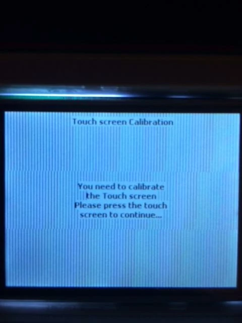

    I am experiencing something very similar. I used the Demonstration as a starting point, and in the file: LCDConf_stm32f429i_disco_MB1c I added a new define called LANDSCAPE, so that I can clearly show the parts of the code that I changed. Here are the affected snippets:
    #ifndef LANDSCAPE
    #define LANDSCAPE
    #endif
    #ifdef LANDSCAPE
    #define LCD_MIRROR_Y 0
    #define LCD_MIRROR_X 1
    #define LCD_SWAP_XY 1
    #else
    #define LCD_MIRROR_Y 1
    #endif
    ... and ....
    #ifdef LANDSCAPE
    #define COLOR_CONVERSION_0 GUICC_M565
    #define DISPLAY_DRIVER_0 GUIDRV_LIN_OSX_16
    #else
    #define DISPLAY_DRIVER_0 GUIDRV_LIN_16
    #endif
    #if (GUI_NUM_LAYERS > 1)
    #ifdef LANDSCAPE
    #define COLOR_CONVERSION_1 GUICC_M8888I
    #define DISPLAY_DRIVER_1 GUIDRV_LIN_OSX_32
    #else
    #define DISPLAY_DRIVER_1 GUIDRV_LIN_32
    #endif
    #endif

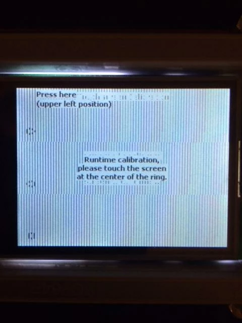

    I then run the calibrate routine from the demo, and this is what the screen looks like on boot ... Landscape works, and the text displays correctly, but the rest of the background looks like it is out of sync or something. I can't help but wonder if there is a problem with the '_OSX_' versions of the driver files? Or am I missing some other important change required in the code? 0690X00000603QbQAI.jpg And then it get's worse, when the next screen paints .... 0690X00000603QfQAI.jpg

    We had confirmation that Landscape mode is not possible in RGB mode with LCD screen controller of STM32F429-Discovery kit.
    So unfortunately today, we can't demonstrate LCDorientation swap using the STM32F429-Discovery kit.
