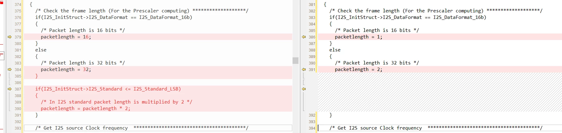

stdlib bug - STM32F4 SPL (Standard Peripheral Library)
in stdlib version1.9.0,

in older version,the same function is

differ as picture above, I think there is a problem. Can you help me with it?

Hello @Ethan1 ,
The change in packet length calculation seems to be an attempt to correct the prescaler computation for different I2S standards and data formats. The older version might have had issues with certain configurations, leading to incorrect clock settings
Regards
Ethan1
Ethan1Author
Jul 14, 2024 4:26 AM UTC
So you mean now version is better? But old project using old version can work normal, after updating 1.9.0, it does`nt work well.
AScha.3
Jul 14, 2024 6:06 AM UTC
So change the
packetlength = 16;
packetlength = 1;
and same for ...32 -> 2 ;
then try and tell...
Ethan1
Ethan1Author
Jul 15, 2024 12:08 AM UTC
you mean change 16 to 1 32 to 2,and try the program, tell you consequence? English is not my mother tougue
