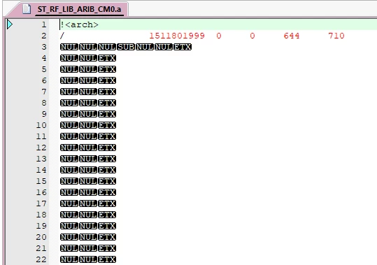

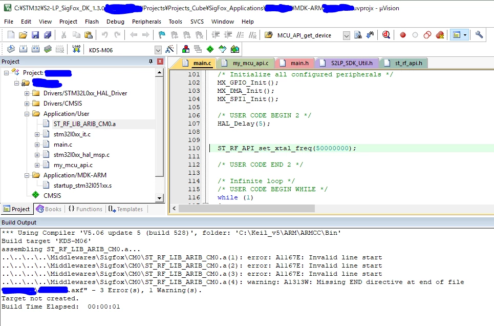

I want to use the S2LP_Sigfox_DK library. The version is 1.3.0.
When I add the static library into my new project that is made by CubeMX, some compile error occurred.
Let me know what should I do.
What did I do is
1) Made a new project bu CubeMX.
2) Add the library ''ST_RF_LIB_ARIB_CM0.a''. (See the following picture.)
3) When I click the error, the library opened as following.
#static-library

    Suggest renaming it as a .LIB file

    Takayoshi Ishii
    Feb 1, 2018 7:34 AM UTC
    Posted on February 01, 2018 at 07:34
    Oh, it works!
    Thank you!
