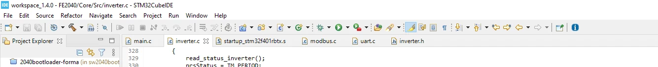

    Clang is decent if you spend a little bit of time customizing what you want. It's integrated in with my IDE and has definitely caught some things I wouldn't have noticed right away.

    Can I use it download it for stm32cube Ide ?
    What about misra coding standard ?

    "eclipse clang plugin" returns promising results.
    What about it?

    Where Can I find to install the clang plugin in stm32 cube ide ?

    this is likely the "CppStyle" plugin. It is installable from the eclipse marketplace.
