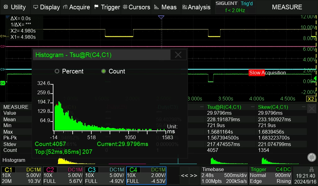

Startup time of NUCLEO G431RB varies greatly
After troubleshooting this issue , i found, that i have a greatly varying startup time.
I have this minimal code:

 I know that some clock setting needs some time, but this? it varies from 100ms to 1600ms !
Could it be, that the chip is bad?

You haven't shown what your clock setup is.
How are you measuring the startup time?
Does it make any difference if the startup is from a power cycle, or just a reset?

I removed my clock setup to create a minimal code. See the picture for the measurement. I do reset with a wavegen.
I also measured with power cycle: With powercycle it was very constant (2.143s).
But now that i switched back, i can not reproduce this issue anymore. Maybe i got the setup not back as it was with the issue? Or maybe a powercycle removed the issue.
It is not constant at about 200us.
