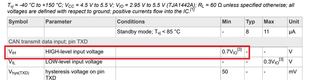

There is an issue in your HW:
VIO pin of the transceiver is connected to 5V.
Going to the datasheet:
VIHmin = 0.7 x 5V = 3.5V < VDD.
You need to connect transceiver VIO pin to VDD (3.3V) not to 5V.
Please don't forget the terminating resistors of 120ohms on CAN_H and CAN_L.

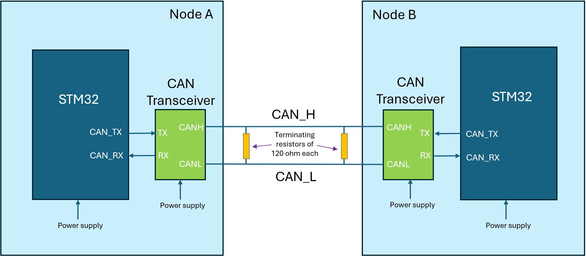

Before going ahead with analysis, could you please tell about your CAN hardware configuration?
1- How are you connecting the two devices? are you using CAN transceivers?
2- Are you adopting this exact structure?: SofLit_0-1729078448084.png
transceivers+ terminating resistors.
If you are using transceiver, could you please provide its part number?

Thanks for the response. It is the same structure as the picture you have provided. Aside from the confusing part where CAN TX and RX must be connected to the transceiver's TX and RX which should not be confused with a USART connection. Everything is connected properly. I am using a NXP CAN transceiver the part number is TJA1442ATK mounted to a DIP8 adapter.
