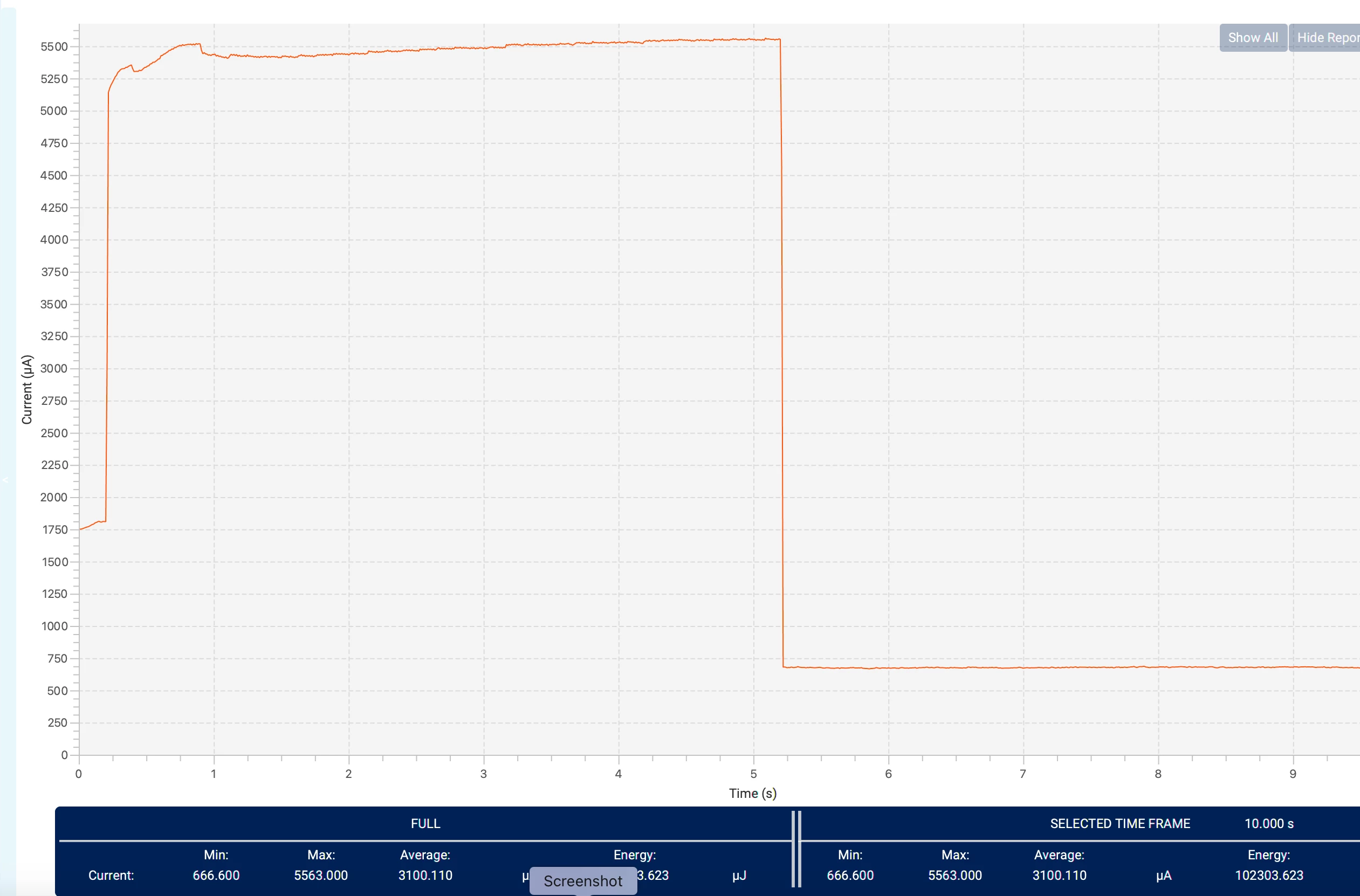

   I have a a stm32L433 48 pin processor and trying to get it into low power. I am using the STLink-V3PWR module with stm32Cube Monitor Power module.   First of all I placed a known value resistor across the STLink-V3PWR to make sure it is reading the correct value, then tried the following:
1. I am using a MIC5219-3.3YM5-TR from the input with the STLink-V3PWR set to 3.6v.  And on its own it draws 85uA.
2. I then added all the resistors and capacitors needed and it measured 96uA.
3. I added the STM32L433 and programmed it to first run for approx 5 seconds in normal mode (16MHz), then drop into standby mode. On the output you can see it drop quite a bit, but the lowest current is approx 650uA (far too much current) as you can see on the graph below.
My code is below after 5 seconds of normal operation. I tried HAL_PWREx_EnterSHUTDOWNMode(); without Putting the Ram in Retention, but still the same,

I found out what the issue was. The STLink-V3PWR  was set for 3.3v , and MIC5219-3.3YM5-TR output is 3.3v. So when the voltage dropped the current went up. I set the STLink-V3PWR  to 3.5v and got down to 60uA in STandby and Ram2 retention.
Scott

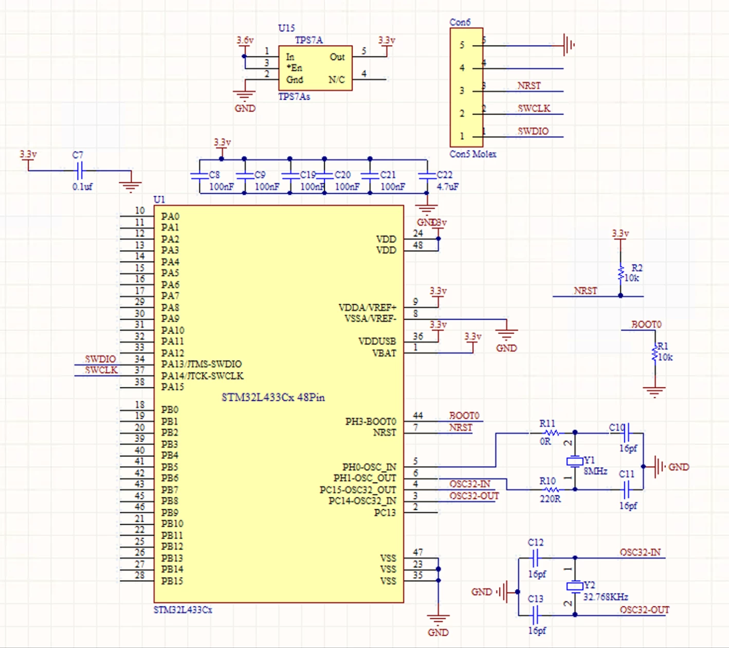

Please show your schematic.
Remember that you must physically disconnect any debug probe to get true low-power readings.
You may need to power-cycle (not just reset) the target after disconnecting a debugger.

Hi
   Its a very min circuit to test it out. I replaced the TPS7A with the MIC5219-3.3YM5-TR.  I am using the STLink-V3PWR with the stm32Cube Monitor Power application. I dont use this for debugging and programming, I removed that, and repowered the board , so the above test was with only the STLink-V3PWR along with monitor app , no debugging was involved. Before doing this I placed a resistor across the STLink-V3PWR and the current is what was expected.
Best Regards
Scott
