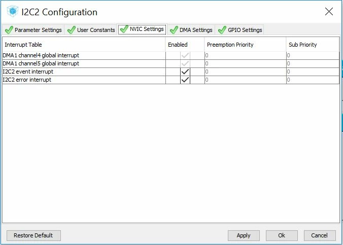

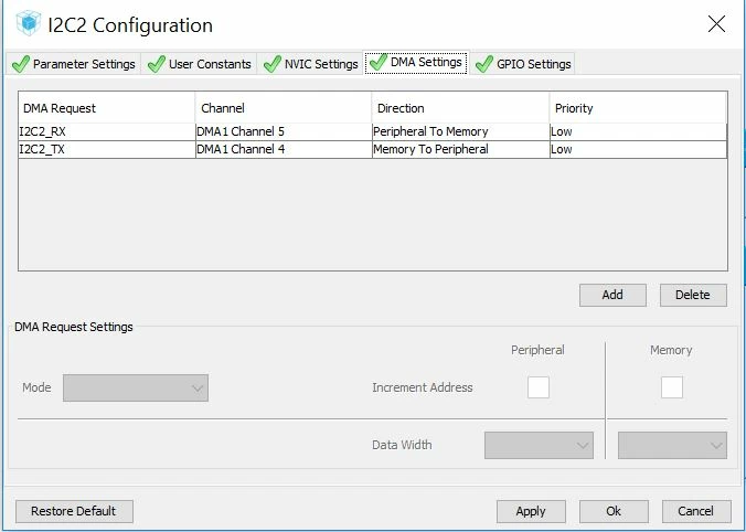

Hi I'm trying to run I2C in DMA mode with LIS35 (accelerometer). I wrote simple code as below but each time when I try to run or debug it I'm getting back return ''LIS35_ERROR;'' which means that LIS35_I2C_Init(void) function goes wrong.
Previously (I mean yesterday) I wrote two similarly projects:
> First was based on HAL_I2C_Mem_Write /
HAL_I2C_Mem_Read  functions
- and all works properly (return LIS35_OK;)
> Second was based on HAL_I2C_Mem_Write_IT / HAL_I2C_Mem_Read_IT
functions
- and all works properly(return LIS35_OK;)
Environment:
- STM32CubeMX - updated today,
- Board - Nucleo-F103RB
- CubeMX project added as attachment
- I2C configuration al on pictures below

Do you see any change in your counters (cntTx, cntRx)?
I have a similar non-working issue with I2C mem Tx with DMA, and I think I have found bugs in the HAL driver code but require more investigation. Your answer to the above question will help, also do you have any other debug information? Are the I2C callbacks activated by DMA transfer complete (Rx and Tx)? Do you know the state of I2C at failure eg I2C_Tx_Busy or I2C_Rx_Busy, and do you have a logic analyzer or DSO to monitor SCL and SDA?
