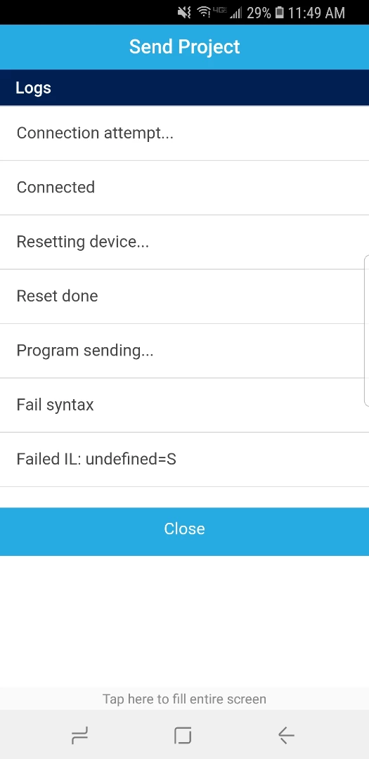

I have built and downloaded the FP_IND_PLCWIFI1 project to the NUCLEO-F401RE board using the IAR version.
I am able to connect to the WIFI, but when sending a project from the ST-PLC-Android app, a failure occurs:
What does this error mean?
Is there a work around?
Thanks,
Dave
#plc #fp_ind_plcwifi1 #st-plc-android

    Hello Dave,
    Based on the error message, seems that the configuration you want to program is not correct.
    Please could you share a print screen of the configuration you want to program?
    Thanks

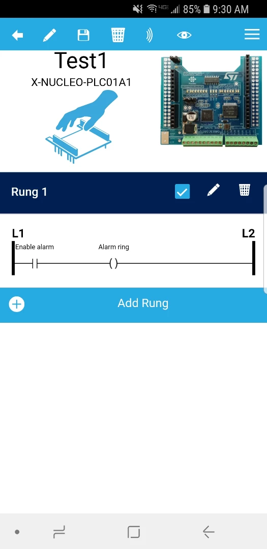

    Dave Bohan
    May 9, 2018
    Posted on May 09, 2018 at 17:51
    Massimo,
    Here is a screen shot of the program I was trying to download:
    Is there a document that explains the ''Send Project'' errors?
    Thanks,
    Dave

    Hello Dave,
    The error is related to the network decoding, but  based on the image seems that the net is OK, maybe there is something wrong in the component position or in the assignment of the component identification label.
    To get more detailed information on how to use the app, you can download the
    UM2284
    and other useful documentation from our website
    http://www.st.com/content/st_com/en/products/embedded-software/mcus-embedded-software/stm32-embedded-software/stm32-ode-function-pack-sw/fp-ind-plcwifi1.html
    http://www.st.com
    Please let me know if you will still have other issues after the user manual check

    Dave Bohan
    May 16, 2018
    Posted on May 16, 2018 at 14:59
    Massimo,
    The manual was not particularly helpful as it does not list any error codes.
    However, I believe that error was caused by an incorrect 'Configuration type' selection: as you can see above, I had 'X-NUCLEO-PLC01A1' selected, but my actual configuration is 'X-NUCLEO-PLC01A1 + X-NUCLEO-OUT01A1'.  The project works fine with the correct Configuration type.
    Thanks,
    Dave
