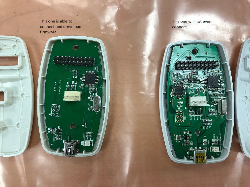

Posted on March 02, 2018 at 01:35
I'm using 2 different ST-LinkV2s to put firmware on a ST32F429ZIT6 processor.  I'm using the SWD interface.  One of the ST-Links works and the other does not.  The one that does not will not even connect to the device.  I took both apart to look at the ST-Link boards.  They are different.  The one that works is sparsely populated while the other has more components on it.  The one that works belongs to someone else and I must return it soon.  What changed and why am I unable to get a SWD connection with the newer ST-Link?
I've perused the web and this forum and found many 'solutions' and tried all of them - none worked.
I've attached a picture of the 2 St-Links.
Both boards are labelled ST-Link V2.0
MB 936 rev B
The one that works has not MFG code and the one that doesn't work has MFG Code 1142.
Any ideas would be appreciated.
Thanks-
Mary

    Posted on March 02, 2018 at 03:35
    Both look poorly made - they look hand soldered. The one on the right had gone through some heavy repair.
    A clone would have worked better.

    Posted on March 02, 2018 at 03:42
    The one on the left is a fake.
    You probably have a problem with connectivity with the one on the right because you aren't powering the buffers on it via the VTarget pins (1 or 2)

    Posted on March 02, 2018 at 21:29
    Clive One -
    Thanks for your response.  The fake ST-Link came from one of our vendors and they instucted me to specifically NOT connect pin 1 (which worked for them).  I'm glad I took them apart and even happier that you knew the solution.  After hooking up pin 1, my ST-Link connects and programs.
    Even though your avatar is no longer Neo, you are still 'the one'.
