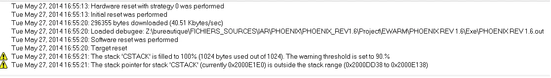

I'm programming a STM32F205. I program it with a J-LINK and IAR, and it works well.
Now I'm trying to use a ST LINK V2. It seems to program my microcontroller, because I have no error, but I have a warming with the size of my stack.
I have already looking for information on the forum.
So I've tried to pull down BootX pins, and it doesn't change something.
When I'm programming my microcontroller with the ST LINK V2 & STM 32 ST LINK utility, it works well.
So now I'm trying to understand why in some cases it works (J-LINK, ST LINK + ST LINK utility) and why in other cases (ST LINK + IAR) it doesn't work !

Concerning the warning, I got the following message :
My stack used the default settings : size : 0x400 (HEAP : 0x200)
It starts at @0x2000DD38 to 0x2000E138

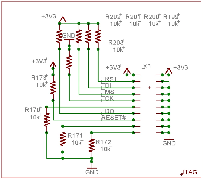

My NRST is tied up to 3V3 with a 10k resistor. It is also connected on the programming connector. I have no specific mode.

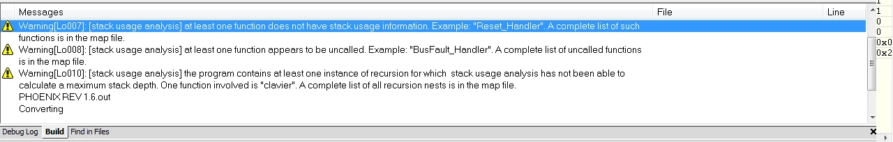

I have also add one option : OPTION --> LINKER --> ADVANCED --> Enable Stack usage analysis and I have the following messages :
fabricepeden

And it what fashion does it ''not work''?
I'm not familiar with IAR, but it seems to be reporting that the stack is now beyond the TOP of it's definition, this is rather odd as the stack travels downward.
Are you using an RTOS that might be allocating different process stacks?
It takes some time to wrestle control of the processor via SWD/JTAG after RESET, if you have code that runs early it may have already executed that before it managed to stop it. You could add a long wait loop to see if that stops the stack scoping error.
The previous stack warnings are from static analysis, basically complaining it doesn't understand how Reset_Handler is called, that another handler isn't called, and you have a re-entrant subroutine it can't make a maximal depth analysis of. You'd need to review the latter to know if it had depth limits, and if so what those were.
The schematic is a bit inconsistent in the use of connections, does the top 3V3 actually connect to the net list for those resistors?

Yes 3V3 is actually connected ? What do you say that it's a little bit inconsistent ?

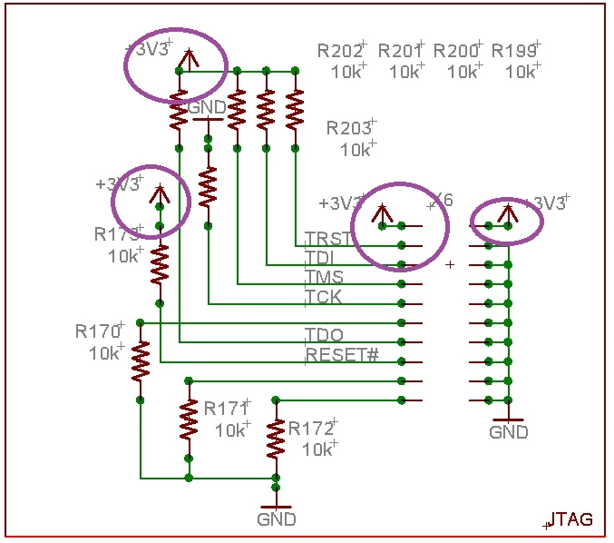

I'm saying that the supply touches the wire in the top example, and touches a junction in the other three. That or you just over use the junction designator. I'm not familiar with the tool you are using, and the use of the junction is inconsistent. If I had problems, I'd look for disconnected nets, either via the net list or DRC.

Concerning the 3V3, all points with 3V3 on my diagram are connected at 3V3.
