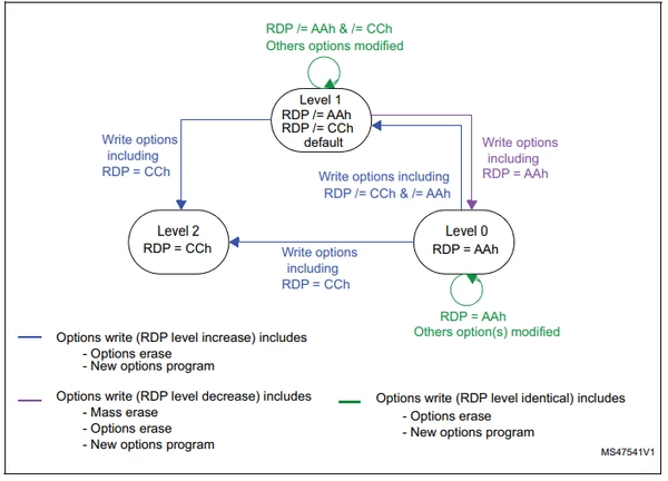

My V2 is having communication link issues with my STVP.  It was running fine and then boom I get hit with a notification that
"Cannot communicate with the device!
Check the SWD cable connection and check all the needed pin connections on the SWD connector.
Reboot the ST-Link with USB cable.
If the device has been programmed with Protection Level 2, no more communication is possible."
What can I do to fix the issue?  I am not sure how to reboot the ST-Link with the usb cable nor understand why all of a sudden there would be a protection level on the device.  I am sorry I am not very tech savy I have been thrown onto this project.
I did have to install the driver once I noticed the connection issue on the device manager.
Please help.

Hello @LostSauceMeatBall and welcome to the ST Community :smiling_face_with_smiling_eyes:.
If a device is in Protection Level 2, it is not possible to recover the MCU. You should have a new one.

September 6, 2024
How does a device get a Protection Level 2?
STTwo-32
STTwo-32Best answer
September 6, 2024
The RDP option byte is set to 0xCC:
