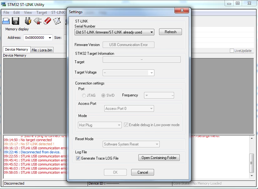

Hi everybody,
I'm currently struggling with flashing a binary file to a custom board including Murata LoRa module (type ABZ) which includes a STM32L0.
Indeed, I have a ST Link, I connect it to the board using SWD with this configurations (ST Link on the left):
- Pin 4 -> GND
- Pin 7 -> DIO
- Pin 9 -> CLK
- Pin 15 -> nRST
The board is externally powered on.

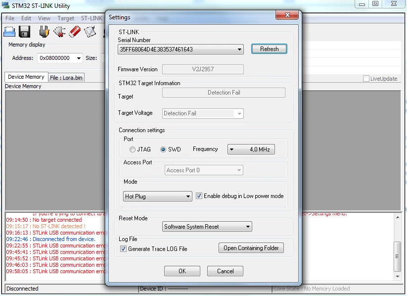

However, when I try to flash the binary file to the MCU, I have several issues. The first one is that I have the message 'Old ST Link firmware/St Link already used' under Target>Settings in ST Link Utility, when I disconnect the ST Link and reconnect it I don't have this message anymore but I have 'Detection fail' in the Target information section and if I try to change something, the Old ST Link... message comes back.
I tried to look at the logs and I found some weird behaviour (especially on voltage detected) and there's apparently also something to do with Read Out Protection.
Anyway, I search for a solution but did not found one that solve my problem so that is why I ask here if someone can help me.
I join some screenshots of ST Link Utility and the corresponding log traces.
If someone can help me, I would much appreciate it
