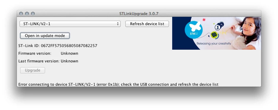

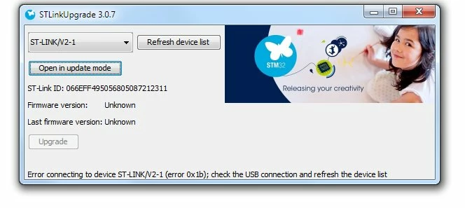

    carmine
    February 26, 2016
    Posted on February 26, 2016 at 06:56
    I can confirm the same issue and several people are reporting me the same problem. After updating the ST-LINK firmware to the latest 2.26.15, the ST-LINK interface nor longer works, and it's neither detected by the STLinkUpgrade.
    This is the error message that appears:
    The LD1 led remains fixed red while the STLinkUpgrade tries to connect to the ST LINK interface.
    carmine
    February 26, 2016
    Posted on February 26, 2016 at 07:23
    I've found a solution.
    1. Download this old ST-LINK firmware from
      https://www.dropbox.com/s/bm0cq4qo1mui1t0/stsw-link007.zip?dl=0
    2. Connect your development board to the USB interface.
    3. As said above by SC, do a quick shortcut between SB11 and RST pads (they are located on the bottom side of the board).
    4. Start the STLinkUpgrade 3.0.3 (the one downloaded before) and downgrade the firmware.
    5. Disconnect your Nucleo board from USB and reconnect it again.
    Full instructions with pictures
    http://www.carminenoviello.com/2016/02/26/restore-st-link-interface-bad-update-2-26-15-firmware/
    S C
    February 29, 2016
    Posted on February 29, 2016 at 13:42
    Hello cnoviello,
    Thank you for your solution. The real problem has been identified, it happens on systems doing the USB command ''get device descriptor'' after the ''set configuration'', which seems common on MacOS at least. A fix is being prepared. Meanwhile the firmware at
    http://www.st.com/web/en/catalog/tools/PF260217
     has been downgraded back to V2J25M14, and can now be used also as recovery.
    Your workaround is the only solution on failing configurations. Another workaround is to downgrade the ST-Link firmware from another host where the issue is not present.
    Sorry for this issue and thank you again for your help in understanding and solving it
