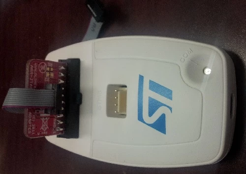

    The ST-Link is very cheap
    The Segar J-Link is cheap for personal use but around £600 for commercial use.

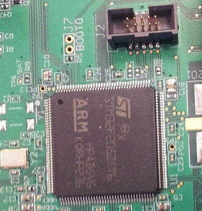

    Generally speaking I'd recommend using the old 20 pin 0.1'' header, as practically everything will connect to it without magic cables. The 10 pin 0.05'' header is what we use for all our boards these days because it's significantly more compact, and new pods will support directly, or with a simple off the shelf adapter.
    Try to avoid using custom headers, or the 5-6 in-line connector used by ST on the DISCO boards.
