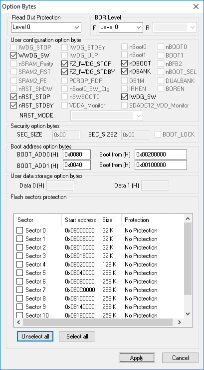

    The STM32 world is new to me. So I'm doing my best to find the watchdog settings you mentioned above. I made my way to "Option Bytes" using the ST-Link Utility application and have attached an image of what I'm seeing.
    I really have no clue as to whether these are correct or not per your post above. I will do some reading up on what each of these options means... in the meantime could you offer an opinion as to whether these settings might be posing a problem?

    It *looks* like both watchdogs are not activated automatically --- if a checked checkbox means bit set to '1'. Regarding the ST-Link Utility I had an unpleasent experience with a H743 where the sense was apparently inverted, hence I woudn't rely on that. So to be really sure, I'd inspect location 0x1FFF0000, it should contain 0x5500AAFF, the factory default.
    BTW Did you check the NRST pin? An internal (watchdog) reset should be visible there. Only a few us, though. And after an unsuccessful programming attempt, did you inspect the memory, i. e. was the internal flash programmed completely or only partially? Same for the external flash.
    And did you measure the time from start of programming to failure? Always precisely the same or grossly varying?

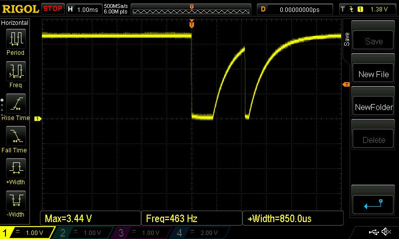

    2.) I scoped the reset line. I am, in fact, getting a 3V3 to 0V transition lasting ~4ms on every disconnect. I have attached a capture of the plot. It falls, then tries to come back up after ~1ms, falls again and finally goes high again after ~4ms.

    I'm afraid that looks like hardware defect to me. You've ruled out cables, power supply and you can program the internal flash successfully (for the blinky), so the external flash is causing trouble, I guess. The reset pulses can hardly be internally caused as the watchdogs are neither activated automatically nor by firmware, so probably by the STLink.
    Very littel hope, I suppose. You could try to program the whole internal flash with random data and read back this to verify that all sectors are ok, just to confirm it's not the internal flash. Write protection is not likely either, as STLink Utilily would certainly detect this at the very beginning.
