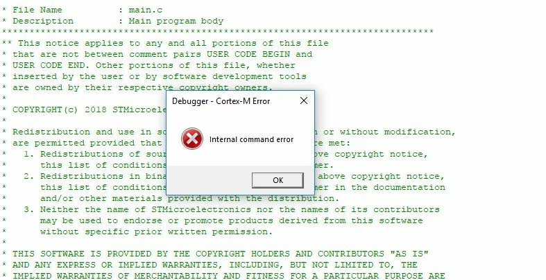

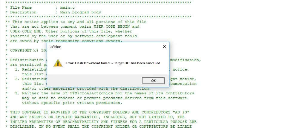

I am getting the following error. Can you please suggest what is the problem?

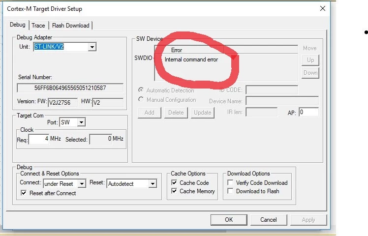

    Run ST-Link utility - check the firmware freshness - the current is : V2J28S7
    Check cables.

    I looked into:
    http://www.st.com/content/ccc/resource/technical/document/release_note/98/de/c7/1b/08/82/44/38/DM00107009.pdf/files/DM00107009.pdf/jcr:content/translations/en.DM00107009.pdf
    'On ST-LINK/V2 boards, update the firmware to the version
    V2J27S6'
    so assumed that st-link is V2 version.
