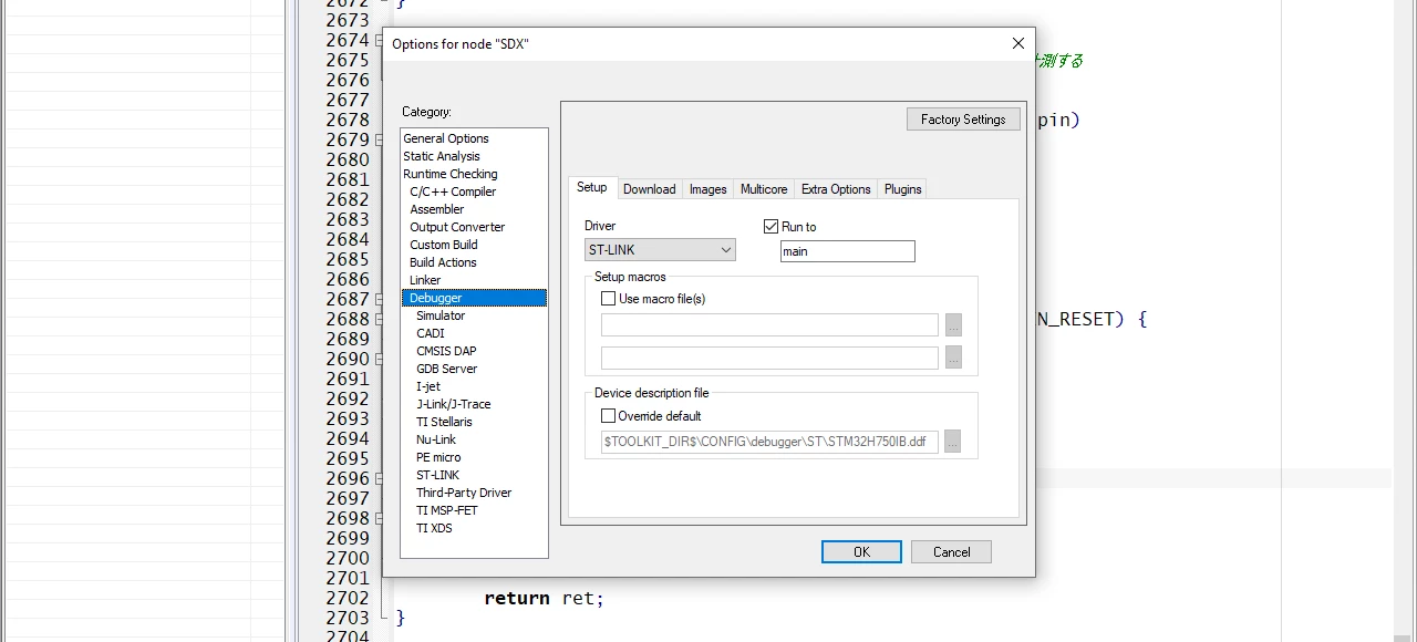

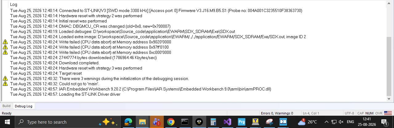

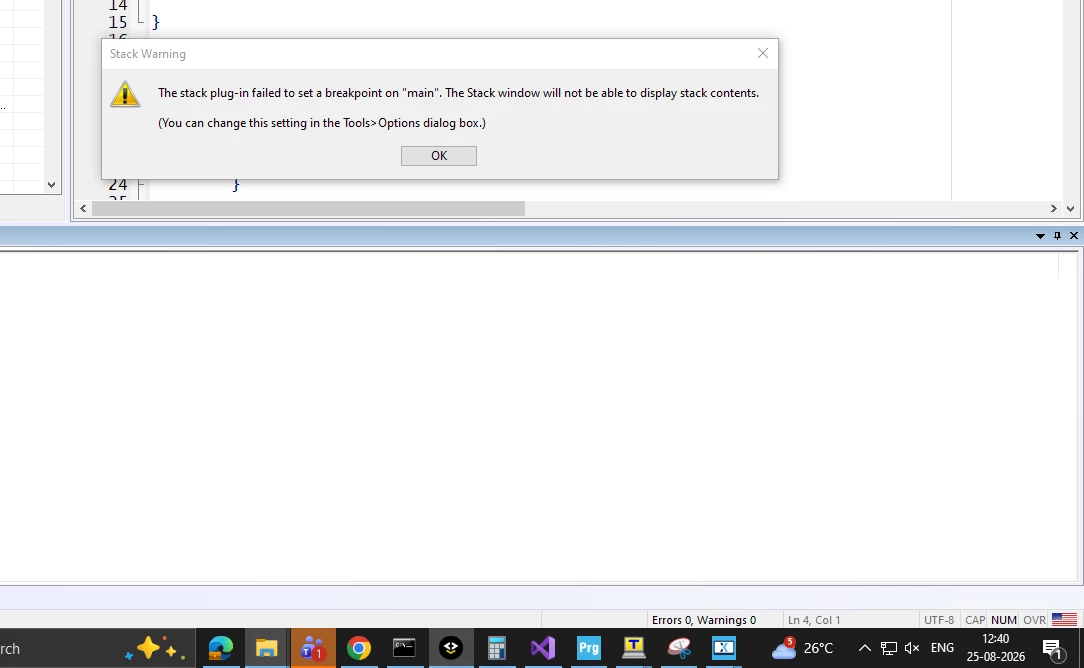

I am running into a frustrating issue while trying to debug my project. Whenever I start a debugging session, the debugger fails to hit or start from the main () function.
I have already double-checked and configured the settings under Tools > Options > Debugger [adjust path if necessary], but the issue persists. Because of this, it's extremely difficult to step through the code and understand the execution flow from the beginning.
Environment Details
  • IDE / Version: IAR EW 9.20.2
  • Language: C/C++ touch GFX framework is there
  • Operating System: Windows
  • STM32H750IBTx
What I've Tried
  1. Checked and re-configured the debugger paths under Tools > Options > Debugger.
  2. Cleaned and rebuilt the solution/project.
  3. Kept breakpoint one the very first line of code after main ()
Error Message / Behavior
  • The execution does not stop in main () entirely or throws a symbol loading error.

Check that the correct ELF/OUT file and debug configuration are being used, and disable optimization for the debug build. Also verify that symbols are loaded correctly and that the MCU startup code reaches main(). A breakpoint in the reset/startup code can help confirm where execution stops.
Ozone
Principal
August 25, 2026
There is quite a bit happening before an application reaches main().
Have you tried to set a breakpoint at the reset vector entry ?
In some IDEs, this amounts to unmark a “Run to main” setting for the debugger.
