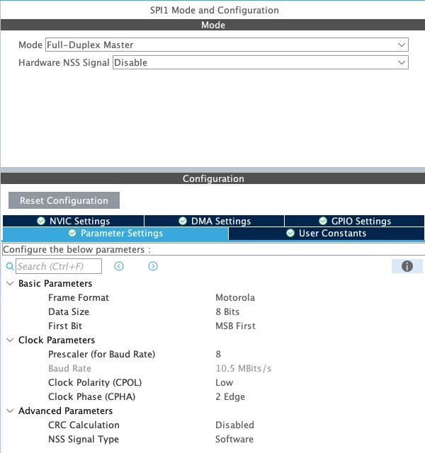

I am writing a driver for the mt6701ct rotary magnetic encoder, using cubeIDE and an stm32f405 MCU. This sensor communicates via SSI, which is to say that it's read-only (MISO-only; there is no physical connection to MOSI).
Using a simple polling strategy, I can communicate fine with this sensor using HAL_SPI_Receive().
I'd like to learn more about using DMA for this though, and am interested in trying to get circular DMA working.

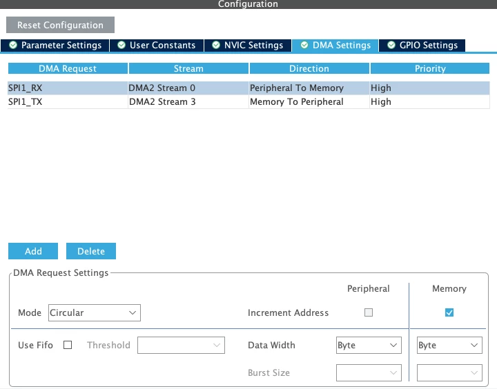

My SPI is configured like so:

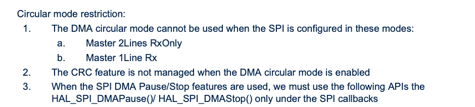

The HAL Reference Manual notes:
To try to sidestep issue #1 with my SSI setup here, I do this in my code to start the circular DMA:

// IMPORTANT! On Page 1033 of the HAL Reference Manual,
// there's a note that says we can't use circular DMA
// with SPI with only RX data (which is what we want).
// To get around this, what I'm doing is creating a
// dummy TX buffer, and then using HAL_SPI_TransmitReceive()
// to simultaneously send and receive data. There is no
// physical TX connection here, so this does nothing really,
// it's just a workaround to allow us to do this DMA trick.

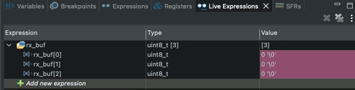

To try to add bit more info:
I thought to try using HAL_SPI_DMAPause()/Resume() because this sensor sends a 24-bit chunk of data, 6 bits of which are a CRC that I need to manually decode before doing some math to turn the remaining 18 bits into a floating-point angle. All of this seemed arduous enough that pausing the DMA while I was doing that seemed prudent, but maybe not.
But, setting that aside for the moment: I'm currently trying to simplify thing by pulling all of that out. Currently, I simply do:
uint8_t tx_dummy[3] = {0x00, 0x00, 0x00};
uint8_t rx_buf[3];
HAL_GPIO_WritePin(SPI1_CSN_GPIO_Port, SPI1_CSN_Pin, GPIO_PIN_RESET);
// Now, start the DMA read
HAL_StatusTypeDef hal_status;
hal_status = HAL_SPI_TransmitReceive_DMA(&hspi1, tx_dummy, rx_buf, 3);
while(1) {
 osDelay(pdMS_TO_TICKS(10));
 Then I enter the debugger and monitor rx_buf:
Gif compression aside (the values change more rapidly than what is seen here), this doesn't look like meaningful information to me - the values only switch between 0 and 255, e.g.
I wonder if it is relevant to highlight that I'm doing this from within a freeRTOS task? rx_buf is currently declared a global within one of my tasks. It feels as though I am making a mistake with correctly writing to a memory location or something, but this is where I'm bumping up against my inexperience.

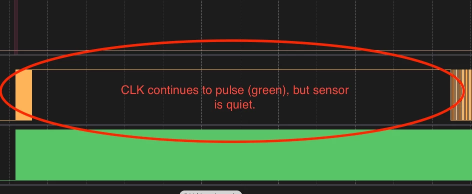

Have you observed the signals on the pins?
sb_stAuthor
Senior
January 15, 2025
Oh good question, thanks - I think this led me to a great clue!
  • Yes, to your first question: as I mentioned in my initial post, the sensor works fine using SPI in a polling fashion. I can get data, parse it, check the CRC, get a floating-point angle. It all works fine.

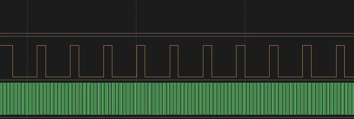

  • To your third question, I did that just now; the results offer some clues. At first, I see the sensor seemingly providing meaningful data. My logic analyzer seems to have trouble making sense of things, I think maybe because it's unclear where one transaction ends and another starts (but that's me guessing):

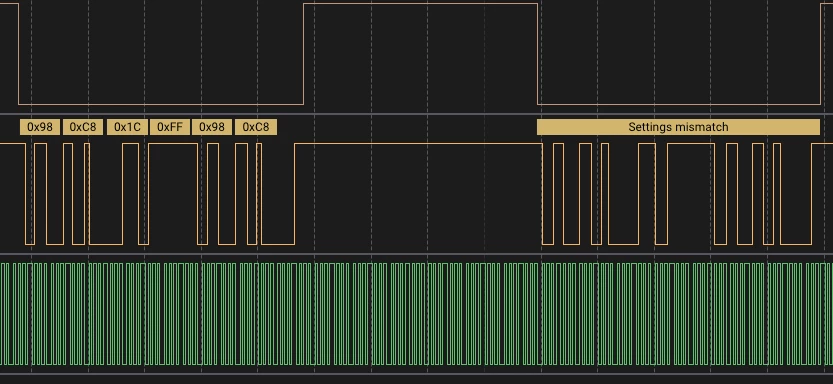

  • Then, after a brief period, it seems like the sensor stops providing output:
    It seems to stay in this state for a bit:
    Then finally starts pulsing what I'm guessing is an error signal:
All of this led me to realize that I never pull CS High again after each individual transaction (which is what I do when reading the sensor in a polling fashion). From Page 23 of the sensor's datasheet:

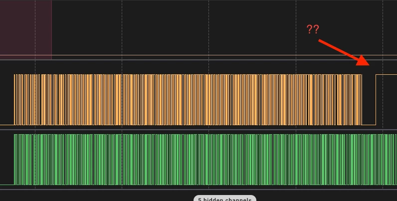

This kinda-sorta seems to work - when viewing my angle variable in the debugger, I see it now reporting meaningful, reasonable values. Except, it seems kind of "stuttery" - it sort of returns a few good values, then hangs for a while (seemingly), then returns more values, hangs, etc.

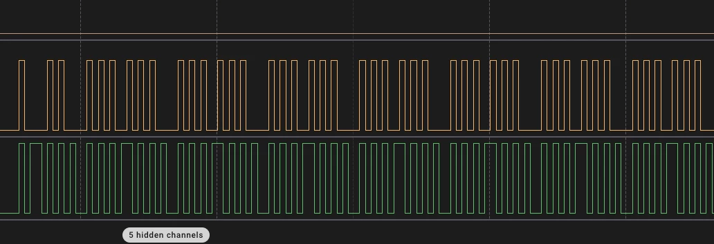

When inspecting things now with a logic probe, I see this:
 I wonder if what's happening now is that things are no longer properly synchronized - it looks like the SPI clock continues to run separately from me yanking CS high or low.
Stepping back: I wanted to try digging into this to learn, but am I choosing a poor test case for circular DMA? I can't tell if I'm using this as it was intended to be used or if I'm just inadvertently creating a bigger problem for myself.
waclawek.jan
January 16, 2025
Yes you probably are.
Framing SPI transfers by signals like chip-select/slave-select/load/whateverisitcalled is - quite logically - a repeating theme here. The usual solution is just to perform the transactions using polling/interrupts/DMA, and "manually" toggle the CS pin.
If you'd want automation, one of the solutions would be to generate both the SCK clock and the framing signal using timers, and feed them back externally from TIM pins to SPI pins, running the SPI as slave. Another option is to use SPI as usually, and feed the SPI data register (i.e. Tx, which determines the clocks) from a DMA driven by a timer, from which a slave timer derives the framing signal. There may be other options, too, but only rarely offer any of these any significant benefit over the "manual" solution.
