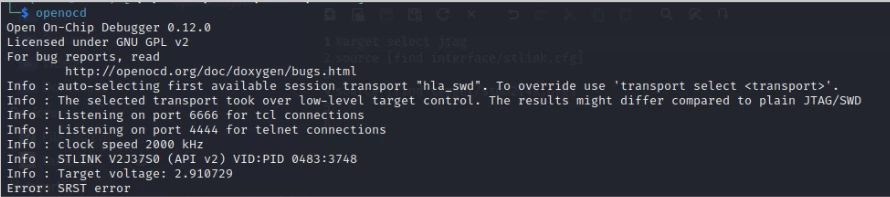

i got a stm32f4 and wrote some code to it, then tried to run openocd  and got this error
my openocd.cfg
note - i reflashed the stlink a couple of times and changed it to jlink(and then back to stlink) so that might have something to do with it.
would very appreciate any help :), i've been stuck on this for a week now

Did you end up solving your issue? I am currently stuck with the same problem after reprogramming my stlink with jlink firmware and then back to stlink.
Visitor II
December 18, 2024
Never mind, I resolved the issue by updating the ST-Link using ST's STLinkUpgrade tool. This resolved the problem.
