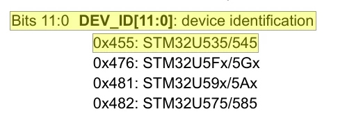

  "deviceId" : 1109,
thats 0x455
and the “little” ‘U535/545 does not have SRAM3 at all.\

I exported a JSON of the option bytes from CubeProgrammer.
"deviceId" : 1109,

Jul 15, 2026 6:50 AM UTC
  "deviceId" : 1109,
thats 0x455

I looked at the rest of my boards closer and as it turns out, it is just one board that has had this happen to it. I really thought it was multiple but either they fixed themselves or there were other issues that were manifesting similarly. My guess is that this specific chip must be damaged. Still curious how it would bootup with an incorrect bit set...
