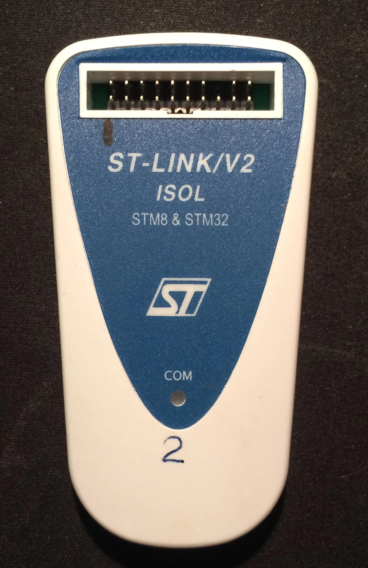

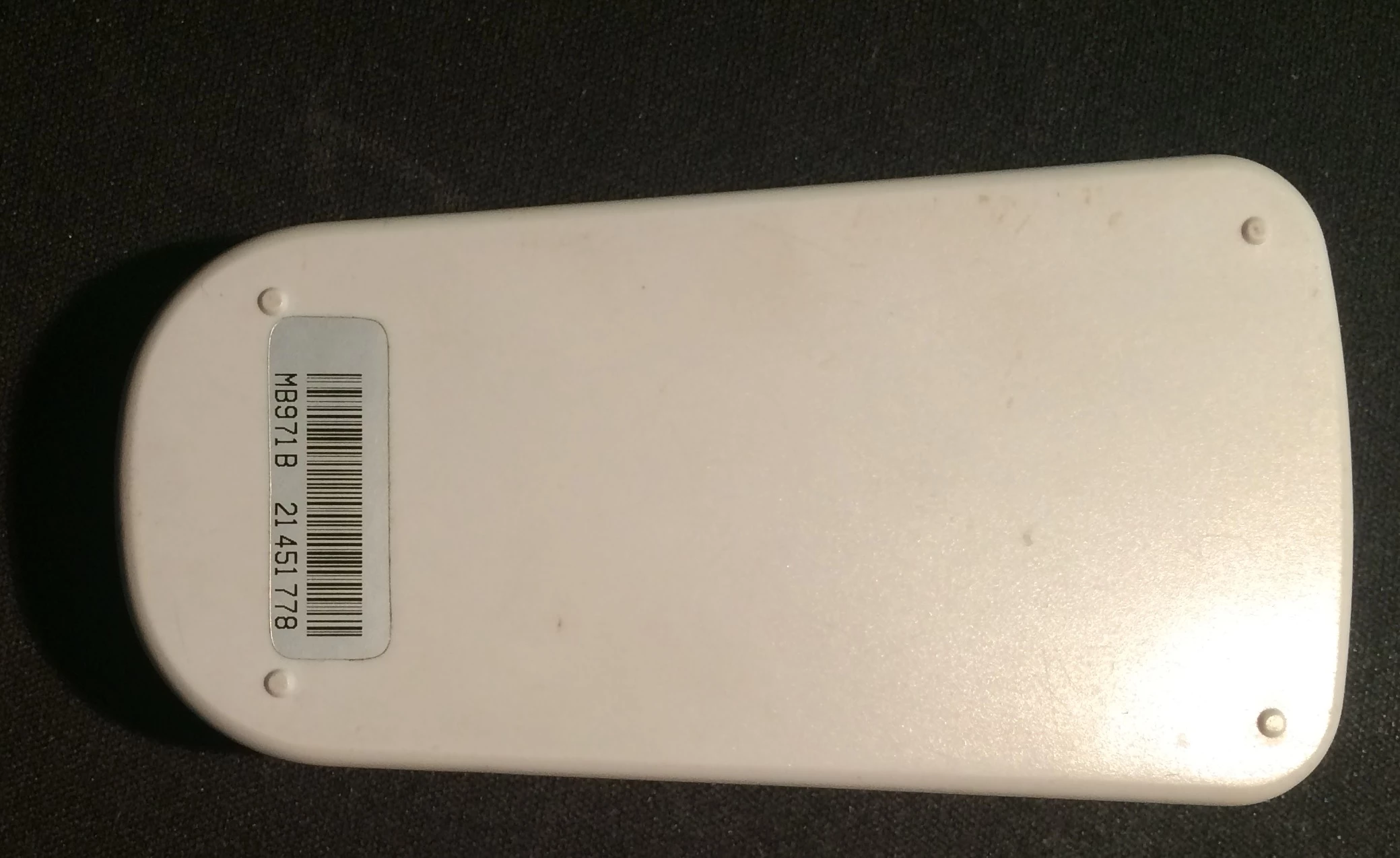

  • What software did you use to read SRAM2?
  • Can you upload a photo of the ST-LINK/V2, preferably with front and back?
Please see attachments. I bought few from Digikey and ST directly once they become available on the market; I believe they are original. Firmware is of course the latest.
