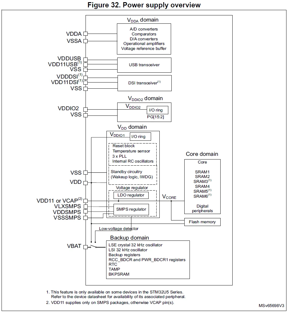

Hi @PScal ,
The SRAM2 is contained in the Core domain,  in should not affected by the reset of the Backup domain which contains : the LSE, LSI, Backup registers, RCC_BDCR and PWR_BDCR1 registers, RTC, TAM and Backup RAM.
I understood that you are not using the tamper unit, then there is any System reset on your application? Are you entering in low power mode (Stop modes, Standby, Shutdown or Vbat)?

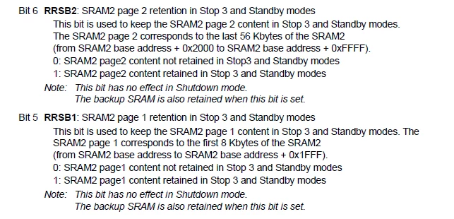

Thank for the description, I just want to check something. By default in Standby mode the contain of all SRAMs are lost unless you activate the RAM retention with the RRSB2 and RRSB1 bits in the PWR_CR1 register (the default value is 0x0000 0000) with the function HAL_PWREx_EnableSRAM2ContentStandbyRetention.
Best regards,
Aime

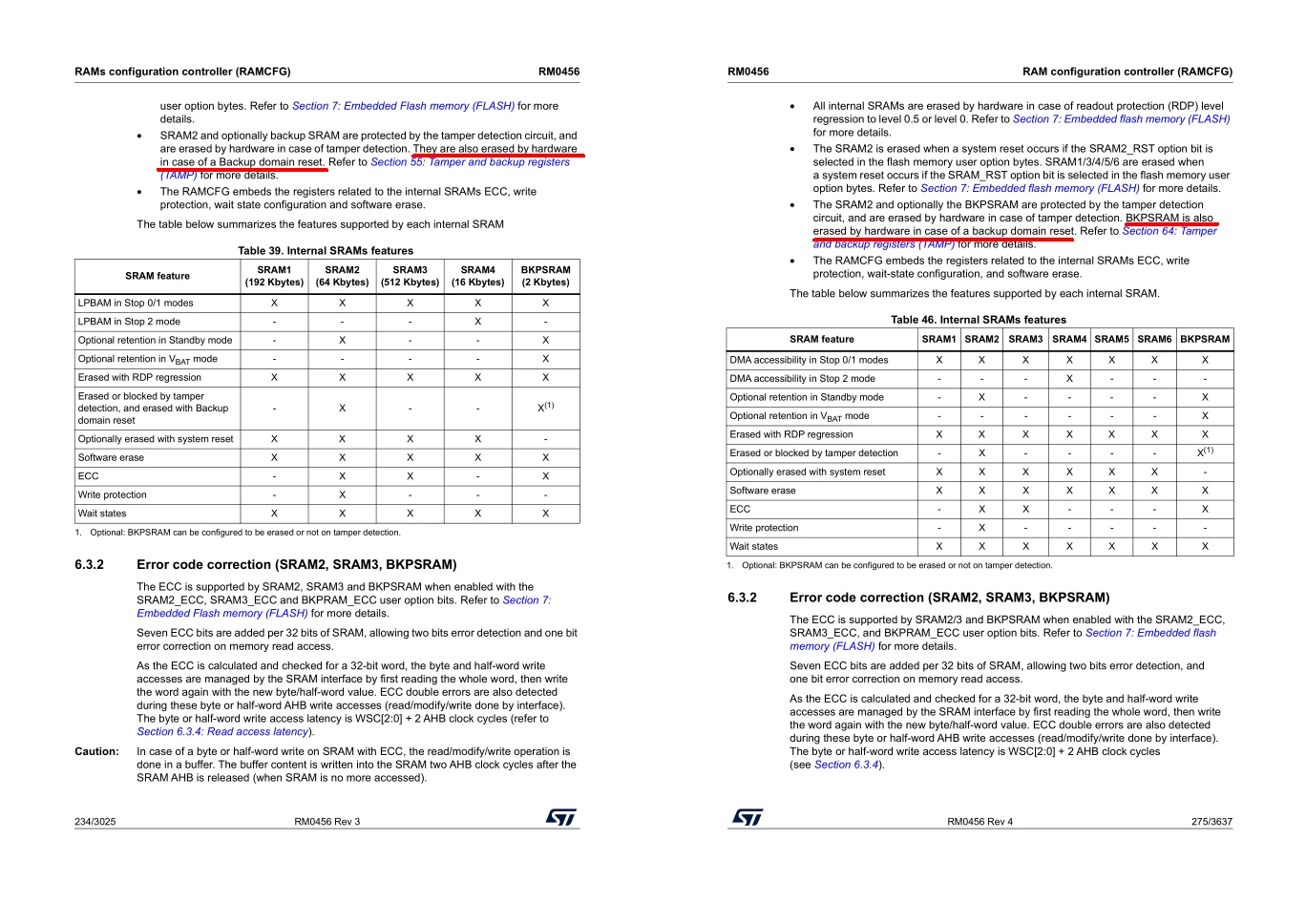

waclawek.jan
July 2, 2023
It's unsettling to find out that ST does not document all changes in silicon between revisions in the ES.
[EDIT]
This change has been specifically made in the RM:
And this is even more unsettling: the RM now deliberately incorrectly describes the behaviour of the Rev.X silicon.
Btw. the most recent Erratum which does not mention this change is dated March 2023, whereas the RM which does reflect it is dated February 2023...

July 3, 2023
Dear @waclawek.jan ,
Thank you for pointing this miss, much appreciated, We confirm  that the behavior  will be added in STM32U5 Errata as already done in STM32H5 series here : STM32H562xx/563xx/573xx device errata - Errata sheet  in Limitation 2.2.14 SRAM2 is erased when the backup domain is reset  that describes how to safely erase SRAM2 and avoid corruption of data not in purpose ( done for example during startup) and more important to describe the behavior observed by @PScal . Now for recent revW, that behavior is changed and indeed Reference Manual Rev4 take it in charge with a delayed synchronization for the Errata as described by @Aime .
Hope now, the situation is more clear.
Cheers,
STOne-32.
